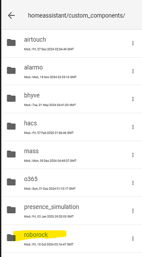

Maybe you did a manual install. If so, go to the custom_components folder in your config and check if you see a folder there named roborock or similar. remove that and restart.
just upgrade to 1.0.16 and it should work again
Yeah I posted a screenshot above of the folder being there: Roborock integration fails to load - #9 by alexdc
Is there a way to bulk delete everything in the folder? It won’t let me delete the folder if it’s not empty.
Used samba share to delete the folder from my windows machine.
THAT DID IT! Thank you!
I had to restart HA after deleting the folder
