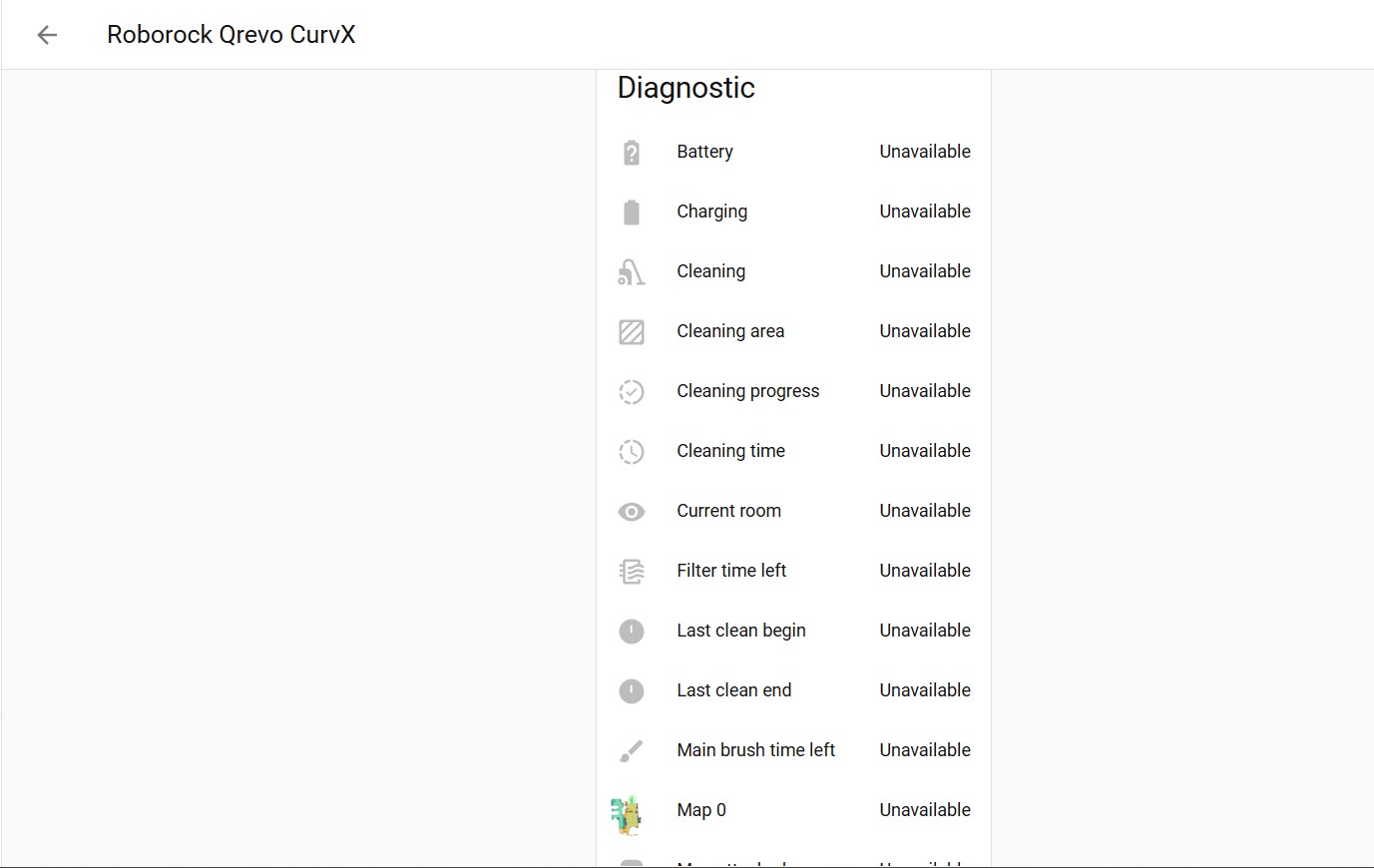

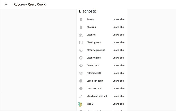

I am facing a persistent issue with the Roborock integration in Home Assistant. The device becomes unavailable every day, and the only way to restore functionality is to remove the linked Roborock account and add it again. This cycle repeats daily.
