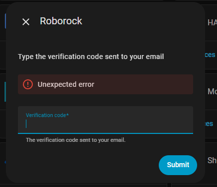

Hi there,
I am having some trouble with the Roborock Integration. At first, it worked perfectly for weeks, then somehow I got a error message. I tried deleting the integration and reconfiguring it, but now I get an “unexpected error message” after entering the confirmation code. I also tried different email addresses to make sure the error wasn’t related to my account, but the unexpected error message occurs with all email addresses I tried. I also tried the troubleshooting steps listed in the official documentation (revoke authorization), but that didn’t help either.
Restoring a backup is not an option at this time, as the error first occurred two weeks ago and I have made some changes in HA since then that I don’t want to lose.
Is there a way to delete the existing data from the integration so I can start over? It wouldn’t be a big deal to lose the integration data and start from scratch if that’s the best way to go.
Btw, my vacuum is a Qrevo MaxV and a S5 Max. Controlling it via the app works fine.
Here is the log file from Home Assistant:

Same for me. After I added a new vacuum I can no longer activate integration.
Logs: TypeError: Invalid variable type: value should be str, int or float, got None of type <class ‘NoneType’>
