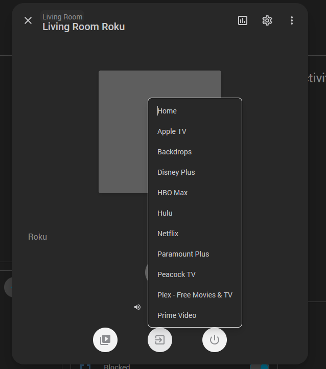

Click your media player in HA and look at the sources, it will look the same as the picture I provided above.
