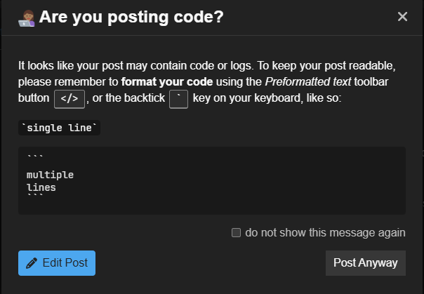

Yes but when I did a cut/paste it warned me to not paste code so I did what it said in order to get it to post without the warning. And i do get an error---it's the one that says cannot connect to Roku API
Should I post it and just ignore the warning?
That log message is the doctored logs though, its' not the raw logs. There's a button you have to click to view raw logs that may expose more logging.
I have no idea what this warning is
That's not a warning, it's telling you how to format your post if it is code.
Ok I must've done it wrong then.

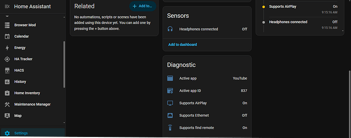

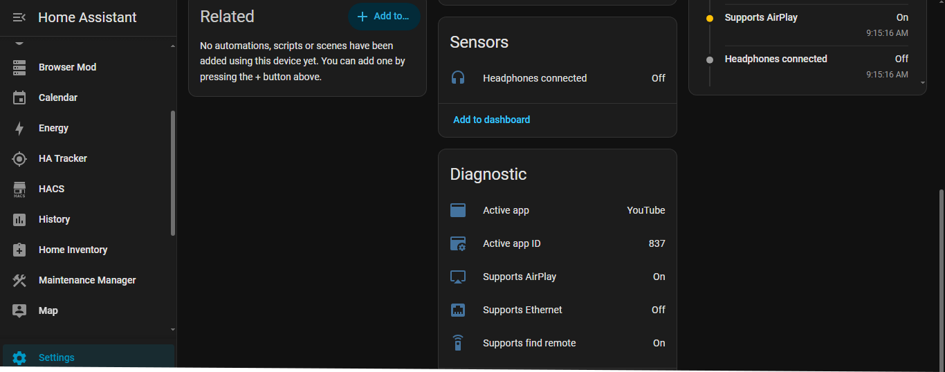

For giggles, open YouTube on the Roku, then check the diagnostics of the device on the integration page.
Check the Active app ID, idk if they're always the same between Roku devices, but mine shows as 837. Try using what yours shows as the source in the automation.
Nice! I'll try that.....
Welp that didn't work.....but it was worth a shot. HA does report the current app correctly tho
