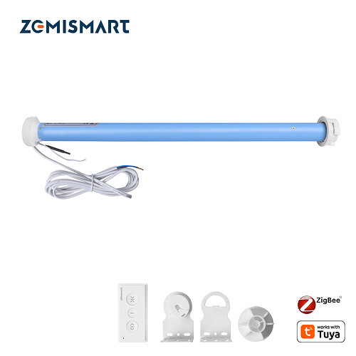

This model is what I’d like to go for:
My VERY stable HA is running ZHA, I’m a noob, I’d like to keep it this way. I would like to put in a lot of roller blinds, I’m wondering if HA users have had a good experience with Zemismart Zigbee and ZHA?
I strongly suggest you search these forums. There’s quite a few threads with feedback on zemismart (Tuya) blinds.
Very good experience here, using 3x ZM25TQ with Zigbee2MQTT. Double check feedback for ZHA if you prefer this platform.
One thread with mention of a driver: Zemismart roller motor ZM25R1 missing controls (ZHA)
But when added with ZHA , no entities available.
Your model is different from the one in the thread you linked.
You’re going to have to create a custom quirk with an additional model TZE200_wdfurkoa based on the existing quirk.
A bit out of my wading depth…
I’ve seen another post with someone running both zha and z2m, with a poe coordinator for z2m. Any recommendations? SLZB-06M, SLZB-MR1?
Todays MQTT update provided full entities for these motors! Yay
