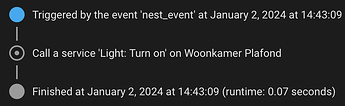

Look at the automation trace after pressing the doorbell: Troubleshooting Automations
Does it trigger 20 seconds after you press the doorbell?
When triggering manually, it flashes within a second. Every time.
This is the Trace Timeline after pressing the doorbell, which took 20 seconds te trigger the lights.
So, it must be the Nest integration, right?
Correct.
