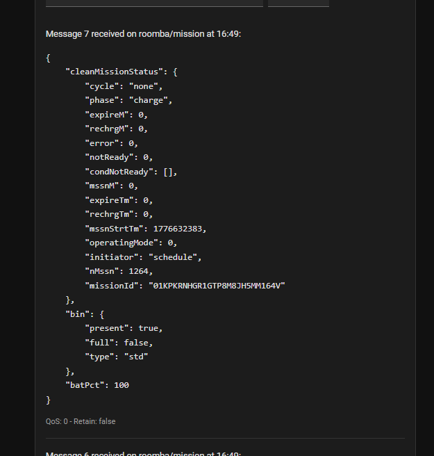

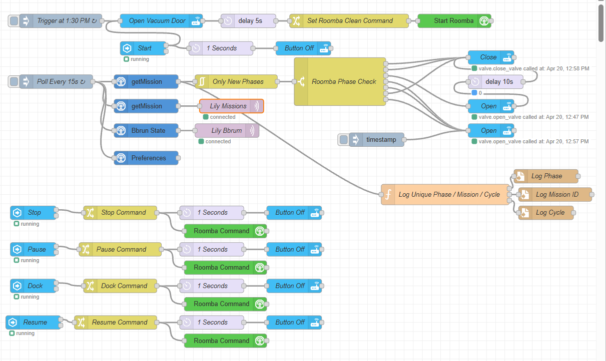

ages ago i did it through node red and MQTT using claude ai to work out some of the finer details … so yeah you could say it can be done

i really only use this to open and close a door which under a kitchen cabinet where the vacuum lives
node-red & MQTT to send commands and listen to what its doing so as to know when to open the door on it return ... so yes it does work
