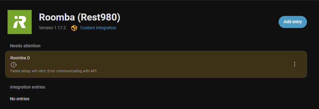

Hi @ia74 . I have tried following the steps and have been able to partly add the integration. What I mean is that, the integration is added but with a Failed setup where is says “Error Communicating with API”. I have got the same result for both Roomba S9+ and Roomba Combo 10 Max (I have 2 Roombas and 1 Braava M6). Would appreciate any guidance on what I can do from here as I am stuck. Thanks

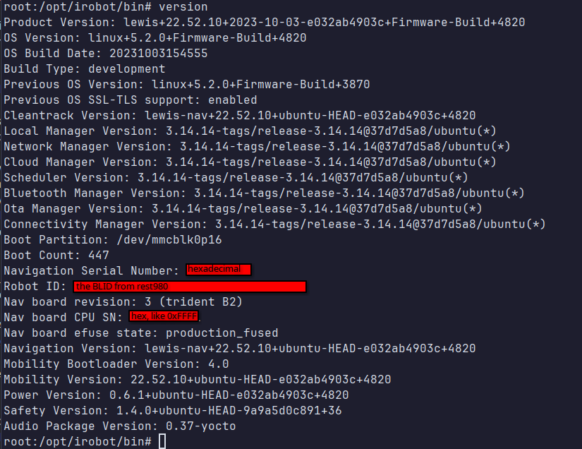

1: For a quick update on that, I’m still looking at capabilities of the jailbreak, like talking to the on-robot navigation motherboard with serial. Still trying to figure a way to get back the real-time pose. Fun fact, the internal MQTT server exposes the Timeline Report that my older robot “doesn’t support”!
Thanks for the reply, I only use the Roombas locally through the HA Dashboard or automation so I don’t use the cloud integration. I’ll block outgoing internet and see what happens.
Side question, if/when the jailbreak is released, would it then be possible to downgrade to the last version of firmware the exposed the x,y,theta?
You know, good point. It very well may be easy, since the update process only replaces some part of an overlay-fs.

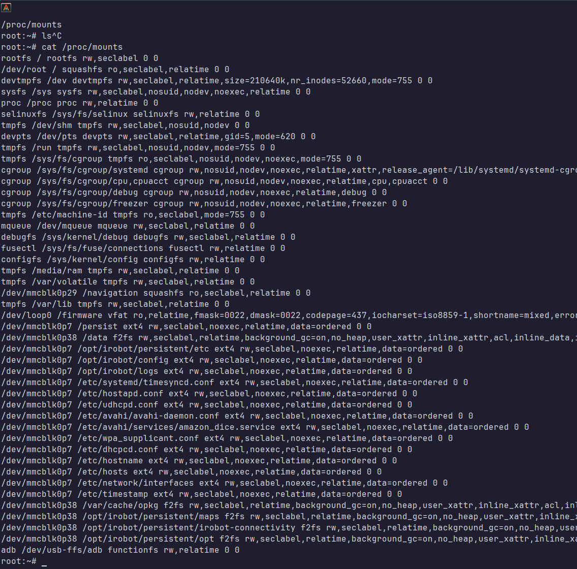

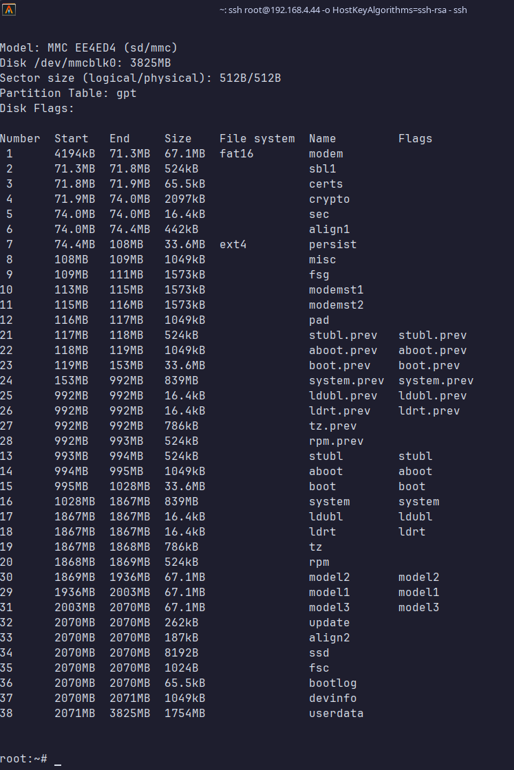

The Roomba has a clever segmentation of its filesystem to make sure persistent things like maps and bootloader stuff don’t get completely broken after bad FW updates (if they happened). Most of the system is actually unwritable because of this; theoretically my idea is we place our own copied ROM/FW image in its spot, and it replaces most if not all of the bits we need.
Partition map (parted -l):
Mounts (cat /proc/mounts, somehow this has parted but not lsblk?!):

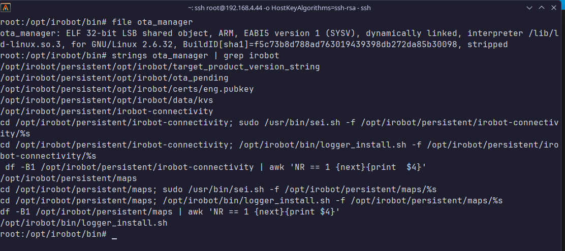

There is a built in OTA manager with a lot of nice strings left in that should more or less help with trying to get it to work in our favor. This should manage OTA updates or atleast download them
More versioning stuff, however all the stuff here is actually given to us in FW update packages (go figure! but hey, it’s less harder than it has to be)
I think I’ve fudged my robot a little, as this actually shouldn’t say Build Type: development because it’s a production build. (oops?)

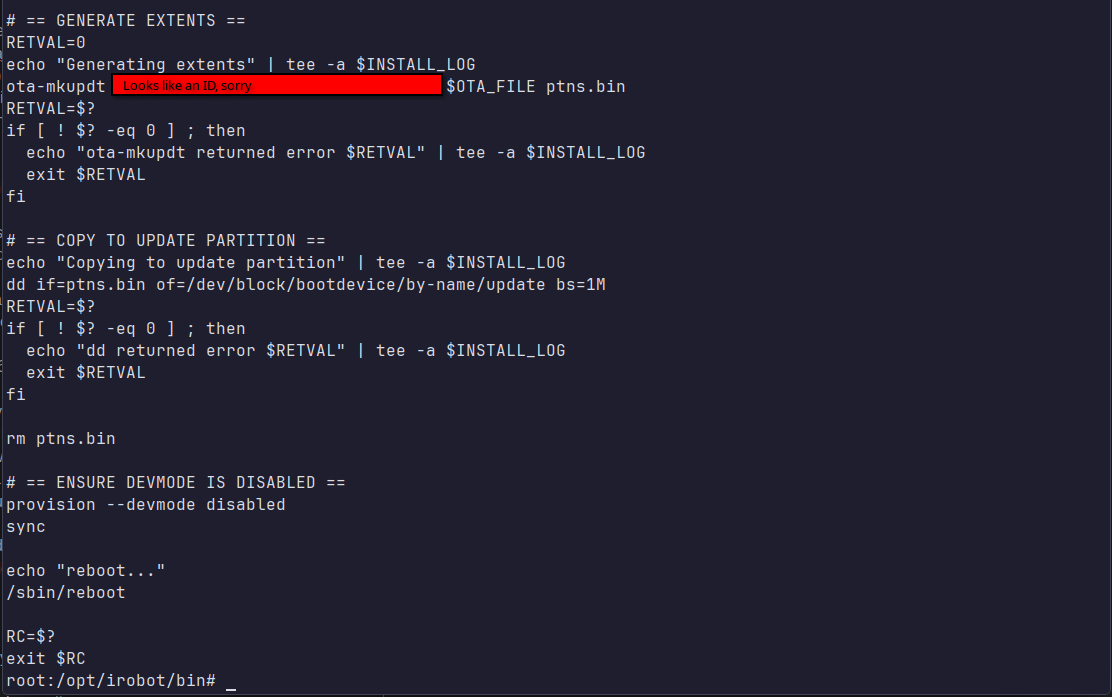

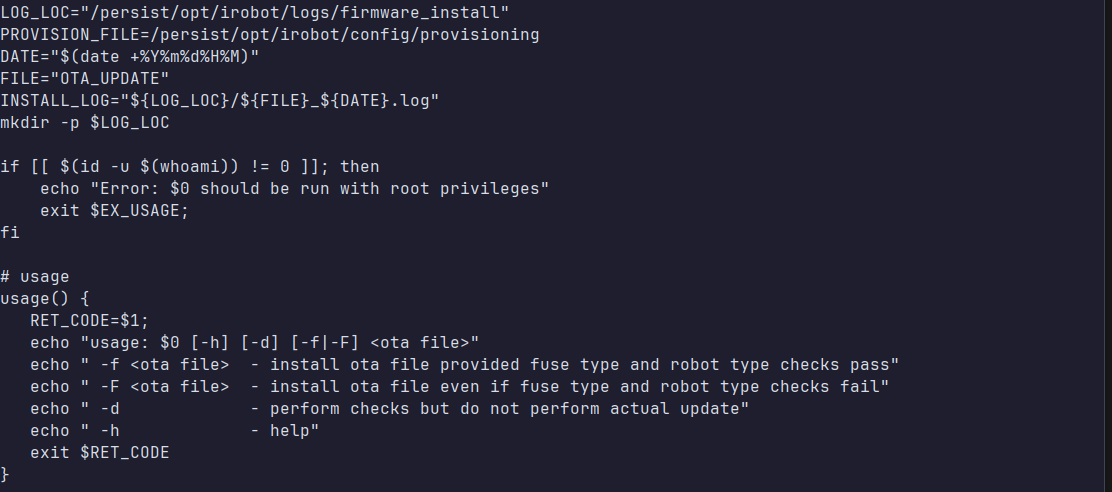

In my search for how the update system works, I found the update script. There is no downgrade protection, and you can straight up force an update from other robot types onto yours (provided you have the FW package)!
The hardest part is getting it into the script, which is simply adding the ota file (downloaded firmware package) to the end of the script.
The fuse stuff is only for checking dev/prod robots, except for some reason you just do -f or -F to force it anyway… Unfortunately I don’t have a dev build to test, but we can get retail ones just fine from the servers. I think with a modification to pass all files we can even do unsigned firmware.
We do need to modify the OTA script to make the jailbreak retain it’s persistence, but that’s just adding like 1 or 2 lines to keep SYSTEM_ACCESS=unlocked (no I’m not kidding).
This is actually really much simpler than I thought to be honest.
