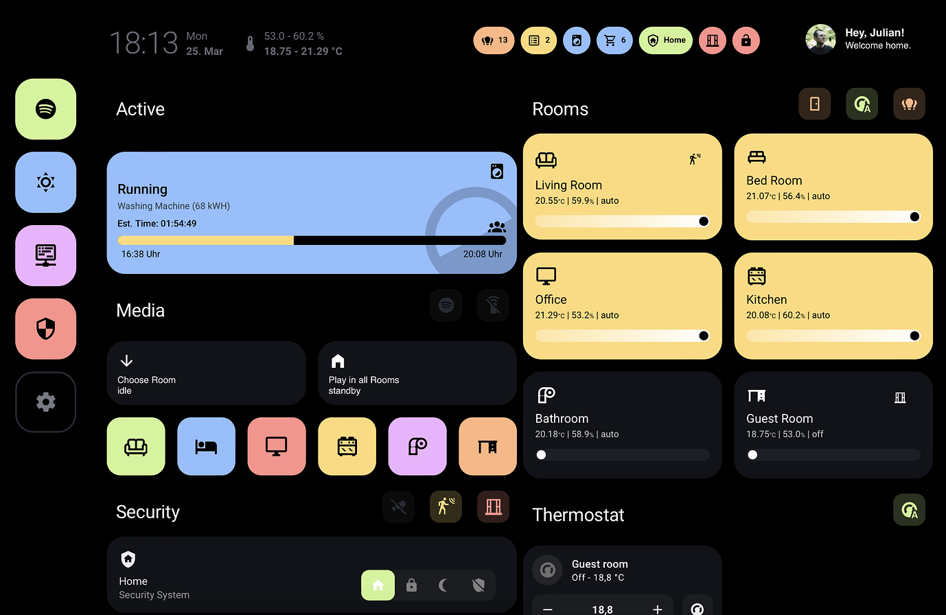

🟣 Rounded - Dashboard guide

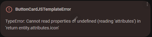

Already did. Furthermore it seems like it fails only on this tile and checking the code of the other tiles did not help. The code of all the devices shown is correct. But thank you though
Forget to mention that it’s only incorrectly displayed when the device is on. When off then it’s fine
I have made a tab card. Every time i pushed the button it increase the background-color contrast.
Does anyone now how to set this off?

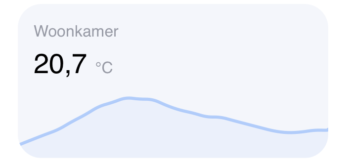

Hi, can you share the code for the temperature card?

Thank you so much for sharing the code! I couldn’t find an “entity” card that fits well with the theme, and you nailed it — well done!

    graph: line
    icon: none
    card_mod:
      class: graph
Result is:
Class was not adopted by the card. Any idea why?
Hi, I have a question because when I insert the code into HA there is always an error?

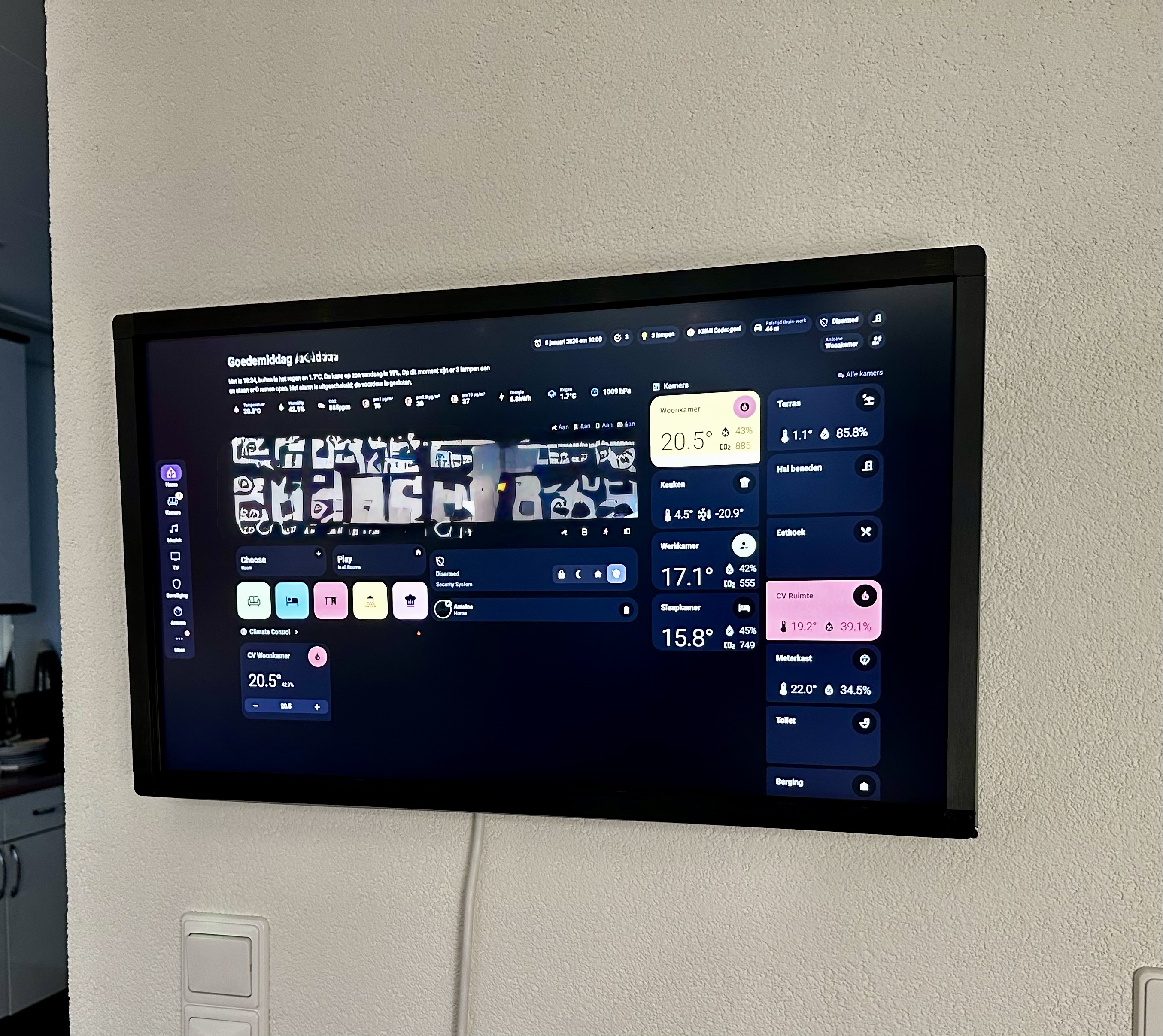

It took me 6 or 7 weeks or so (lead time, not in total :smile:), a lot of learning and help of Claude and ChatGPT but I’m finally there and last week I mounted the first wall panel. I’ve used an old Dell 27” monitor in the living room and will use two smaller ones (15.6/16”) in the bed room and home office. The 27” was stripped and converted to touch using an infrared touch digitizer. Native touch is better but it still works great.
Since I suck at designing I went looking for something already out there. Watched several Youtube vids with catch lines like ‘The ten best dashboards’ etc. and chose ‘Rounded Bubble’ and used the YAML code one of these video’s linked to. If I remember correctly is was 21k lines of YAML originally. Only four or five weeks in I found both this topic and saw @jlnbln (I’ll send you/him a donation) had started creating video’s on Youtube detailing on parts of the dashboard. Oh well, Ai and I managed as described! :wink:
In those weeks the code also made me buy two Sonos ERA 100’s, three N100/N150 miniPC’s the size of a phone (to mount on the back of the displays), two Aqara FP300 motions sensors and swap my battery video doorbell to a wired PoE one. :laughing: I also started using Music Assistant which looks quite familiar to Roon (I have a lifetime license for my main ‘standalone’ HiFi system). Also deployed a PiCore Audio player on an old Pi2B. All this totally worth it for the dashboard and functionality wise.
Not finished yet, like the wake-up alarms but it does read my alarm from my iPhone. I plan on migrating that function to the bed room Sonos. Also working on more reliable presence detection. Thus far I was only using DIY 2410C’s (ESP32 based) in a storage room and rest room. Next I’ll put something together similar to the Everything Presence Pro. Which will be used in other rooms than the FP300’s are in. Both mentioned are sold out all the time, so I’ll diy a bit more.
Here’s a pic, when I just mounted it and the power cable just dangling. I redacted it a bit but it displays three streaming IP cams using the Advanced Camera Card where the garbled parts are.
