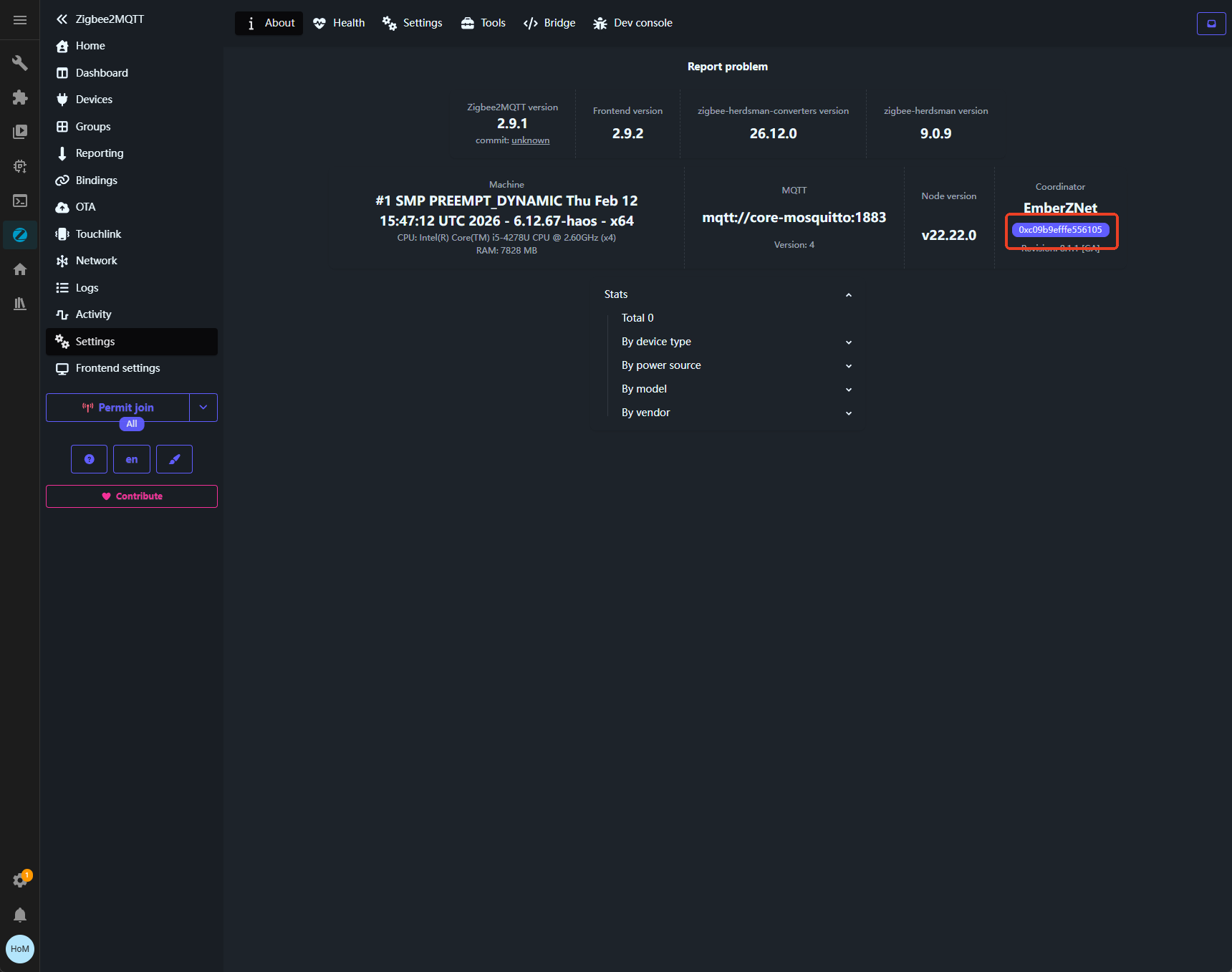

Hi @berni-parrett
Please refer to FAQ | Zigbee2MQTT for migrating from one adapter to another.
Basically, you need to copy the IEEE address of your old Zigbee adapter, and paste it into Dongle-M’ Web UI -> Z2M&ZHA -> Change IEEE address -> Flash custom IEEE address.
You can get the IEEE address of your old Zigbee adapter from Zigbee2MQTT’ Web UI -> Settings -> About page.
