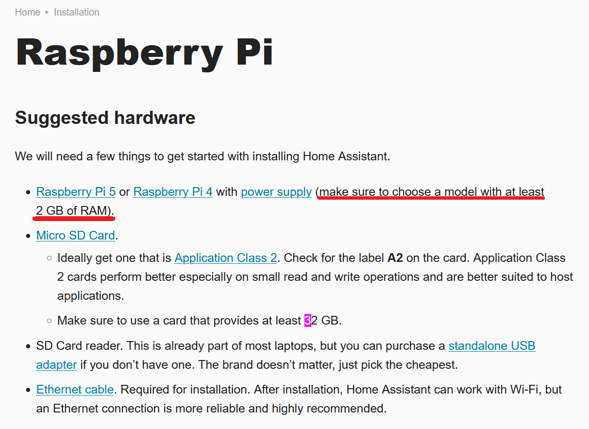

Also, if you haven’t seen this: (from Docs → Installation)
Since the RPi3 has only 1GB RAM…

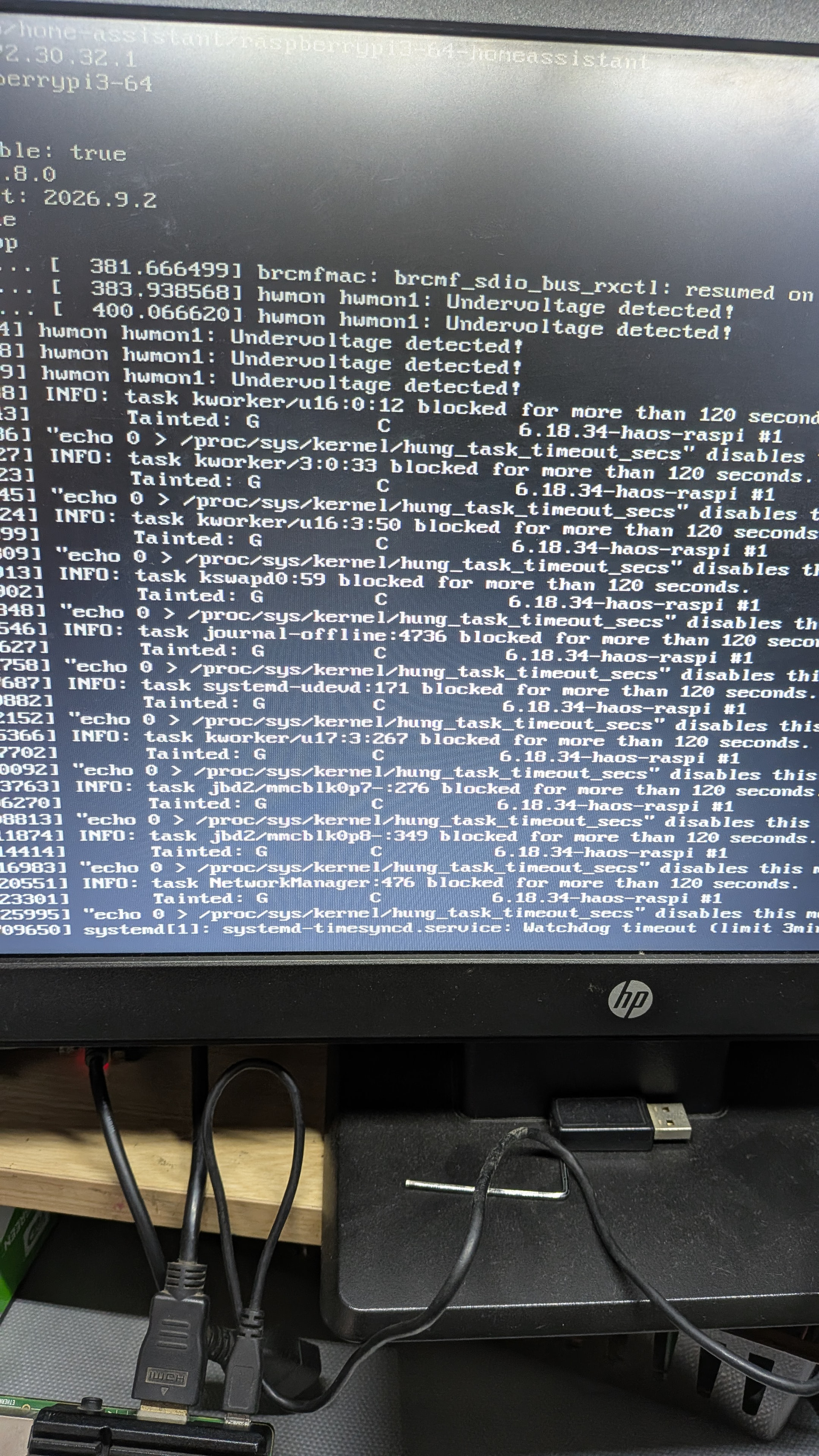

I am using a 3A power adaptor but still the red led goes off & on.
I downloaded the os to 17.0 and noticed it to be stable. Checked for 15 minutes with no reboots. The core is the same.

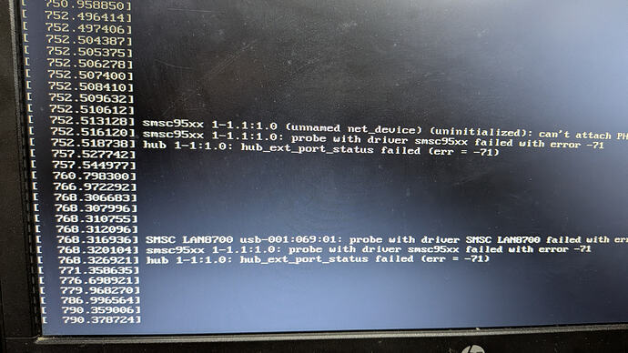

I get some messages on the console which is attached.
Only usb keyboard is connected to USB port.
Update: 2 hours and no reboot. I will keep the OS version.
On PI3, the LAN is managed via a USB Device, directly soldered and connected on the board.
