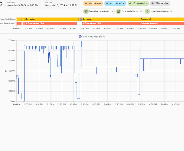

But my bigger concern is crashes.
This integration pulls metrics for 10 batteries. I’ve offset the timing of each pull via the “update_interval” , a technique suggested by some other repos, including the one I forked… Intervial is set to roughly every 5 seconds, and I’ve offset the seconds so most updates won’t run at the same time.
I am getting crashes about every 20 minutes with “Reset Reason” set to: “Software Reset CPU”.
Guessing the crashes are related to the shrinking Heap Block
I’m also guessing the issue is the amount of data I’m trying to return, but that really is just a SWAG.
I’m not seeing a lot of help in the logs.

Can anyone point to good practices for managing memory on ESP32 S3?
Also, can anyone suggest tips on resolving this?
