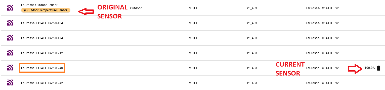

(RTL433/MQTT) The same LaCrosse sensor is detected under different IDs
Long story short - I am getting tired of dealing with multiple devices detected by MQTT over the time for the same LaCrosse weather sensor and would appreciate some good advice how to resolve it.
Please find the details below.
My HA configuration includes:
  • SDR USB stick
  • rtl_433 add-on (link) with the following configuration in rtl_433.conf.template file (showing only important entries):
output json
output mqtt <...> devices=rtl_433/9b13b3f4-rtl433/devices[/type][/model][/subtype][/channel][/id],events=rtl_433/9b13b3f4-rtl433/events,states=rtl_433/9b13b3f4-rtl433/states
protocol 73  # LaCrosse TX141-Bv2, TX141TH-Bv2, TX141-Bv3, TX141W, TX145wsdth, (TFA, ORIA) sensor
  • rtl433_mqtt_autodiscovery Add-On (link)
  • HA MQTT Integration (link)

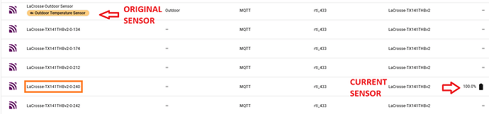

In general, everything works fine, except when the same sensor is discovered under different IDs over the time. Seems to be mostly happening after the HA upgrades or restarts.
So, every time this happens I have to go in, detect and remove old MQTT entries, rename the current one (to make sure my dashboards are not broken). This drives me nuts! Needless to say, that every time I do that, I lose the historical data.

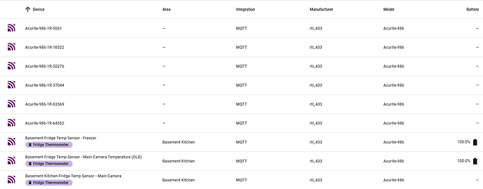

I also have the same issue with a few Acurite fridge sensors:
We can take them out of picture for now, if I learn how to deal with a single LaCrosse sensor, I can perhaps fix them in a similar way.
So, the question is what can I do, to tell it to stop them from multiplying? (and use the existing device IDs, rather then adding/discovering as new)

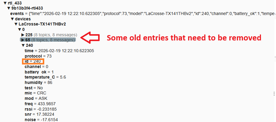

Thank you for the answer, I really appreciate it!
This is the part I don’t understand… entries from rtl433 add-on log:
{"time" : "2026-02-20 12:53:00.810580", "protocol" : 73, "model" : "LaCrosse-TX141THBv2", "id" : 240, "channel" : 0, "battery_ok" : 1, "temperature_C" : 6.300, "humidity" : 99, "test" : "No", "mic" : "CRC", "mod" : "ASK", "freq" : 433.981, "rssi" : -0.190, "snr" : 17.101, "noise" : -17.291}
{"time" : "2026-02-20 13:49:40.822414", "protocol" : 73, "model" : "LaCrosse-TX141THBv2", "id" : 240, "channel" : 0, "battery_ok" : 1, "temperature_C" : 6.800, "humidity" : 99, "test" : "No", "mic" : "CRC", "mod" : "ASK", "freq" : 433.986, "rssi" : -0.198, "snr" : 17.438, "noise" : -17.636}
{"time" : "2026-02-20 15:38:50.808038", "protocol" : 73, "model" : "LaCrosse-TX141THBv2", "id" : 240, "channel" : 0, "battery_ok" : 1, "temperature_C" : 8.600, "humidity" : 99, "test" : "No", "mic" : "CRC", "mod" : "ASK", "freq" : 433.986, "rssi" : -0.254, "snr" : 17.317, "noise" : -17.571}
so, it’s giving me the same “id” every time (until something happens, like HA restart). The end sensor remains untouched.
Does this mean, that the “id=240” was not sent by the device, but (due to missing id from the device) was randomly created after the first packet and cached by rtl433?
Would it be possible and would it help to make it (somehow) “more persistent”, or perhaps increase some timeouts?
I also noticed from the MQTT Explorer, that corresponding end entries (i.e. devices->Lacrosse-TX141THBv2->0>240) sometimes are getting removed and then re-appear. Not sure if this is a glitch or actually happening.

Yes, it’s created by rtl433 when the device doesn’t provide anything unique. And so when either the sensor is restarted or rtl433 is restarted, rtl433 thinks it is communicating with a new sensor and assigns a new ID.
You can read this issue on GitHub where the rtl433 author explains there is nothing he can do about it, some sensors just weren’t designed to provide a unique identifier.
MQTT payloads are either retained (using the retain flag) or not retained. If they are not retained, when you open MQTT explorer you will not see that information until it is published again by the device that is publishing it. MQTT explorer will then hold it in memory and display it to you while you have the program open, but any other client that connects after it was published would never see it (until it is published again).
Conversely if they are published with the retain flag set, you (or any other client) will be able to see the data as soon as you connect to the broker.
Here is the comment in the rtl433 source code for that Lacrosse device:
https://github.com/merbanan/rtl_433/blob/14bba0cc72af5ca06b9cd8e5afb997a25a901102/src/devices/lacrosse_tx141x.c#L62
So based on that, for your Lacrosse device specifically, it is the device that generates the unique ID and it generates a new one upon each power-up.

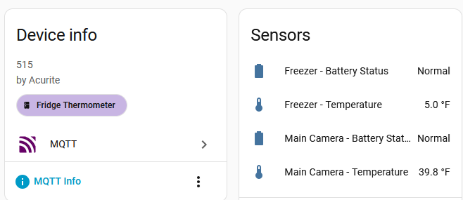

Fortunately for me, I have two different types of Acurite monitors (986 and 515), where each of them has two sensors, that report via different channels in their path. MQTT Discovery usually detects them as 4 separate devices, but I decided to combine them for each fridge.
My final configuration (from mqtt.yaml):
binary_sensor:
  # Acurite-986 Basement Fridge Sensors (freezer + main camera)
  - name: Basement Fridge Sensor Freezer - Battery Status
    unique_id: "basement_fridge_freezer_sensor_battery"
    state_topic: rtl_433/9b13b3f4-rtl433/devices/Acurite-986/2F/+/battery_ok
    device_class: battery
    payload_on: 0
    payload_off: 1
    device:
      identifiers: "acurite986_fridge_sensor"
      name: "Basement Fridge Sensor"
      manufacturer: "Acurite"
      model: "986"
  - name: Basement Fridge Sensor Main Camera  - Battery Status
    unique_id: "basement_fridge_main_camera_sensor_battery"
    state_topic: rtl_433/9b13b3f4-rtl433/devices/Acurite-986/1R/+/battery_ok
    payload_on: 0
    payload_off: 1
    device:
      model: "986"
  # Acurite-515 1st Floor Fridge Sensors (freezer + main camera)
  - name: 1st Floor Fridge Sensor Freezer - Battery Status
    unique_id: "1st_floor_fridge_freezer_sensor_battery"
    state_topic: rtl_433/9b13b3f4-rtl433/devices/Acurite-515/AF/+/battery_ok
    payload_on: 0
    payload_off: 1
    device:
      identifiers: "acurite515_fridge_sensor"
      name: "1st Floor Fridge Sensor"
      model: "515"
  - name: 1st Floor Fridge Sensor Main Camera  - Battery Status
    unique_id: "1st_floor_fridge_main_camera_sensor_battery"
    state_topic: rtl_433/9b13b3f4-rtl433/devices/Acurite-515/AR/+/battery_ok
    payload_on: 0
    payload_off: 1
    device:
      model: "515"
sensor:
  - name: Basement Fridge Sensor Freezer - Temperature
    unique_id: "basement_fridge_freezer_sensor_temperature"
    device_class: temperature
    unit_of_measurement: "°C"
    state_topic: rtl_433/9b13b3f4-rtl433/devices/Acurite-986/2F/+/temperature_C
    value_template: "{{ value }}"
    json_attributes_topic: "rtl_433/9b13b3f4-rtl433/devices/Acurite-986/2F/+/time"
    json_attributes_template: "{{ {'temperature_C':value} | to_json }}"
    device:
      model: "986"
  - name: Basement Fridge Sensor Main Camera - Temperature
    unique_id: "basement_fridge_main_camera_sensor_temperature"
    state_topic: rtl_433/9b13b3f4-rtl433/devices/Acurite-986/1R/+/temperature_C
    json_attributes_topic: "rtl_433/9b13b3f4-rtl433/devices/Acurite-986/1R/+/time"
    device:
      model: "986"
  - name: 1st Floor Fridge Sensor Freezer - Temperature
    unique_id: "1st_floor_fridge_freezer_sensor_temperature"
    state_topic: rtl_433/9b13b3f4-rtl433/devices/Acurite-515/AF/+/temperature_C
    json_attributes_topic: rtl_433/9b13b3f4-rtl433/devices/Acurite-986/AF/+/time
    device:
      model: "515"
  - name: 1st Floor Fridge Sensor Main Camera - Temperature
    unique_id: "1st_floor_fridge_main_camera_sensor_temperature"
    state_topic: rtl_433/9b13b3f4-rtl433/devices/Acurite-515/AR/+/temperature_C
    json_attributes_topic: rtl_433/9b13b3f4-rtl433/devices/Acurite-986/AR/+/time
    device:
      model: "515"
Not sure if I need all those json definitions and value templates, but (after struggling with different combinations), at least it works.
Any suggestion how to simplify this config (if any) would be appreciated.
