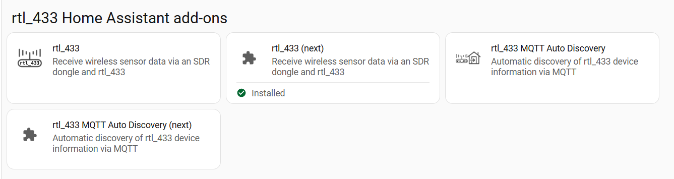

Yoj can skim it as @Vaughan66 said by creating the sensors manually in configuration.yaml. If you only have one sensor it shouldn’t take much time. That’s how I do it with all my 433 sensor. If I let discovery run it would pick up dozens of sensors quickly. Do you know how to get the subscribe topic from mqtt.explorer?
This new verson that doesn’t use mqtt might be more suitable for you if you can get it on your rp4 as it uses an integration to find new devices.
It looks like two of them must be installed on the Home Assistant Server locally and the radio, too. Are you talking about me installing the Python Library.
No. If you can’t easily add those apps to your RPI4 then go down the path of manually adding sensors as yaml to configuration.yaml

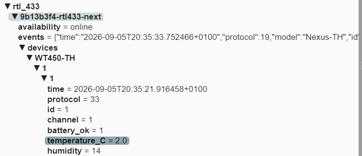

If you are using mqtt then best way to look at it is to use mqtt explorer. It will make it much easier. So download that first and use it to connect to your mqtt server on your RPI4.
Go to your rtl section that should something like this above. Open up the sections until you find the sensor you are looking for. In this example I select temperature_c and then on the right hand side of the screen I copy the subcribe topic and it will look like the line below.
rtl_433/9b13b3f4-rtl433-next/devices/WT450-TH/1/1/temperature_C
using whatever app you use to look at configuration.yaml open it up and if you don’t already have an mqtt section copy the code below. You will have to adjust your code to suite your topic, name probably to reflect your sensor.
mqtt:
  sensor:
    - name: " temperature"
      state_topic: "rtl_433/9b13b3f4-rtl433-next/devices/WT450-TH/1/1/temperature_C"
      state_class: measurement
      unique_id: Garden_temp
save it and then again in HA go to settings/tools/yaml and select the manually configured mqtt entities buttons and it will create a sensor in my case temperature. If you run into problems show me the topic in right hand corner and the value.

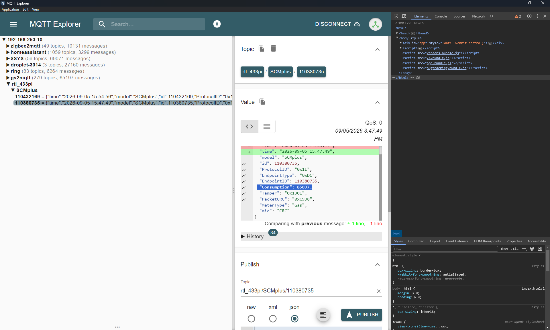

MQTT Explorer:
The topic: rtl_433pi/SCMplus/110380735
Value:
{"time":"2026-09-05 12:11:49","model":"SCMplus","id":110380735,"ProtocolID":"0x1E","EndpointType":"0xDC","EndpointID":110380735,"Consumption":85897,"Tamper":"0x1301","PacketCRC":"0xC938","MeterType":"Gas","mic":"CRC"}

Is there no list with SCMplus under devices?
value_template: "{{ value_json.Consumption }} looks more like it
The value seems to be under “Consumption” (I actually pick up my and my neighbor’s gas meter. 110380735 is mine. The other is his.
