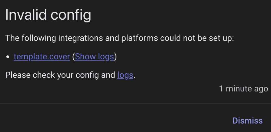

Weirdly HASS reports an error like this:
But when I go to the logs I get this:
Which seems very weird… like it thinks there’s a problem and, it’s not tracking the state, that I can see plainly but it can’t recognise what the problem is it’s detecting.

This is neither the new nor the old format. The new format should be below template, not below cover anymore. And the platform line needs to go. But there need to be more changes done. The easiest way would be to roll back to the old format and install the lastest version if you hadn’t already. Don’t worry, the legacy format will still work for the next 6 months.
The new Home Assistant version 2025.12 will show you a repair message when it detects the old format. That repair message will show you the new yaml you need, ready for pasting. Also check the top post of the below thread with some tips on common mistakes people make when pasting the new yaml.
