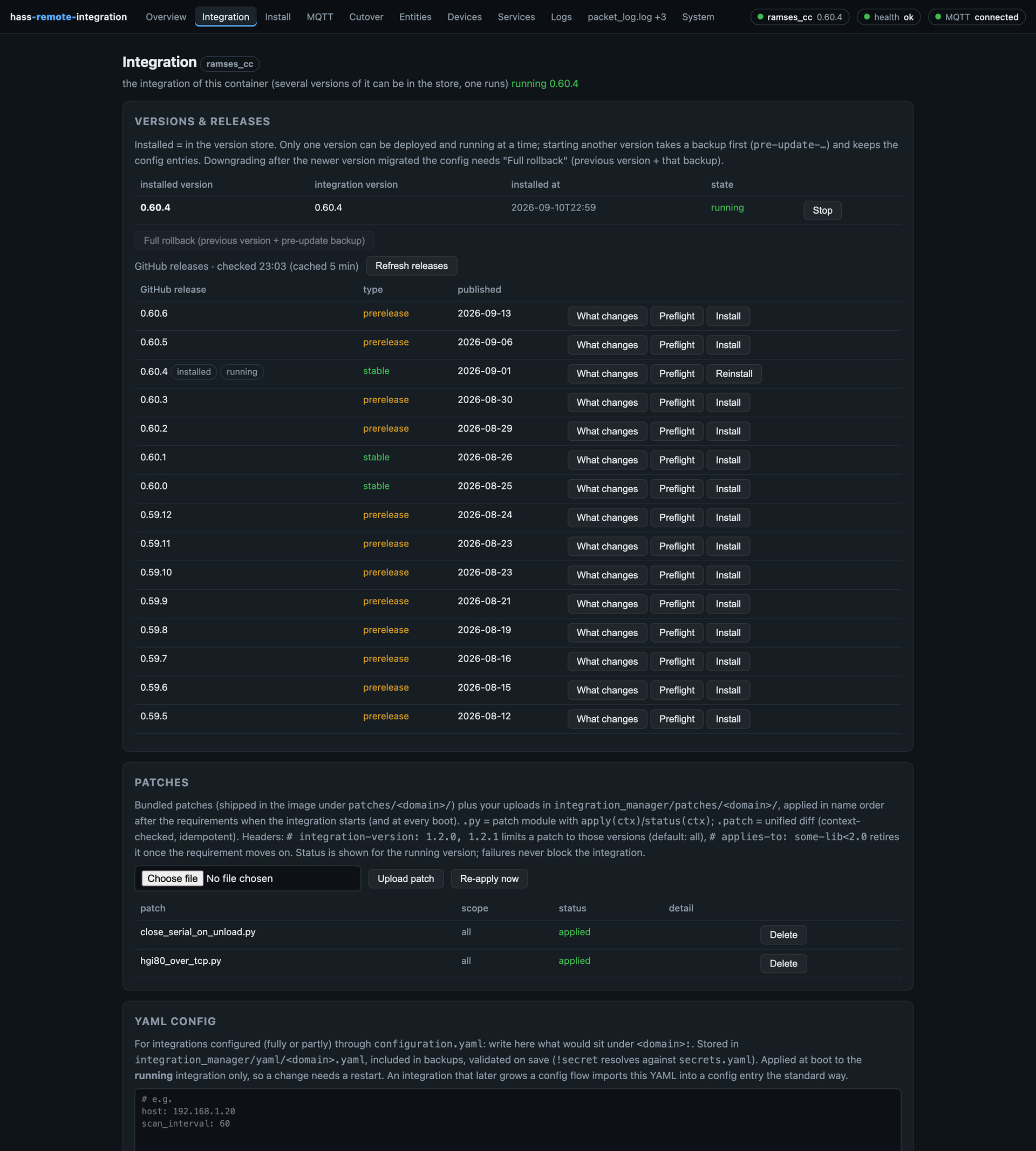

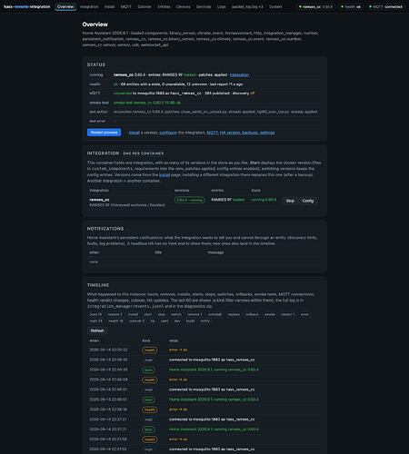

My heating runs on Honeywell evohome, integrated with the ramses_cc custom integration and a radio stick. For the last days that integration has been running inside hass-remote-integration, in shadow mode, next to my main Home Assistant, which still runs its own copy. MQTT discovery stays off until I switch over. Device ids and addresses are masked in the screenshots.
Overview. One integration per container: ramses_cc 0.60.4 is running, healthy and publishing to MQTT. The timeline records every boot, restore, install, MQTT connection and health change.

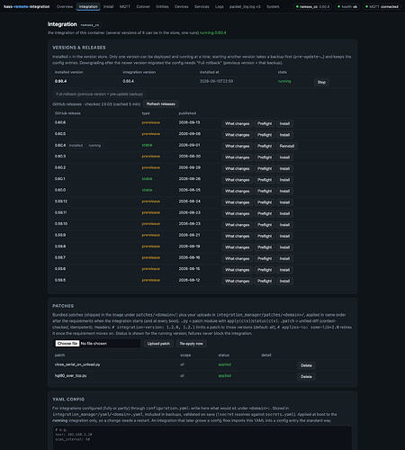

Integration. All ramses_cc releases from GitHub. Each one can be checked with Preflight (requirements, patches, minimum HA version) before installing. The two patches I need for my setup are applied automatically at every start, and they retire themselves once upstream fixes the issue.

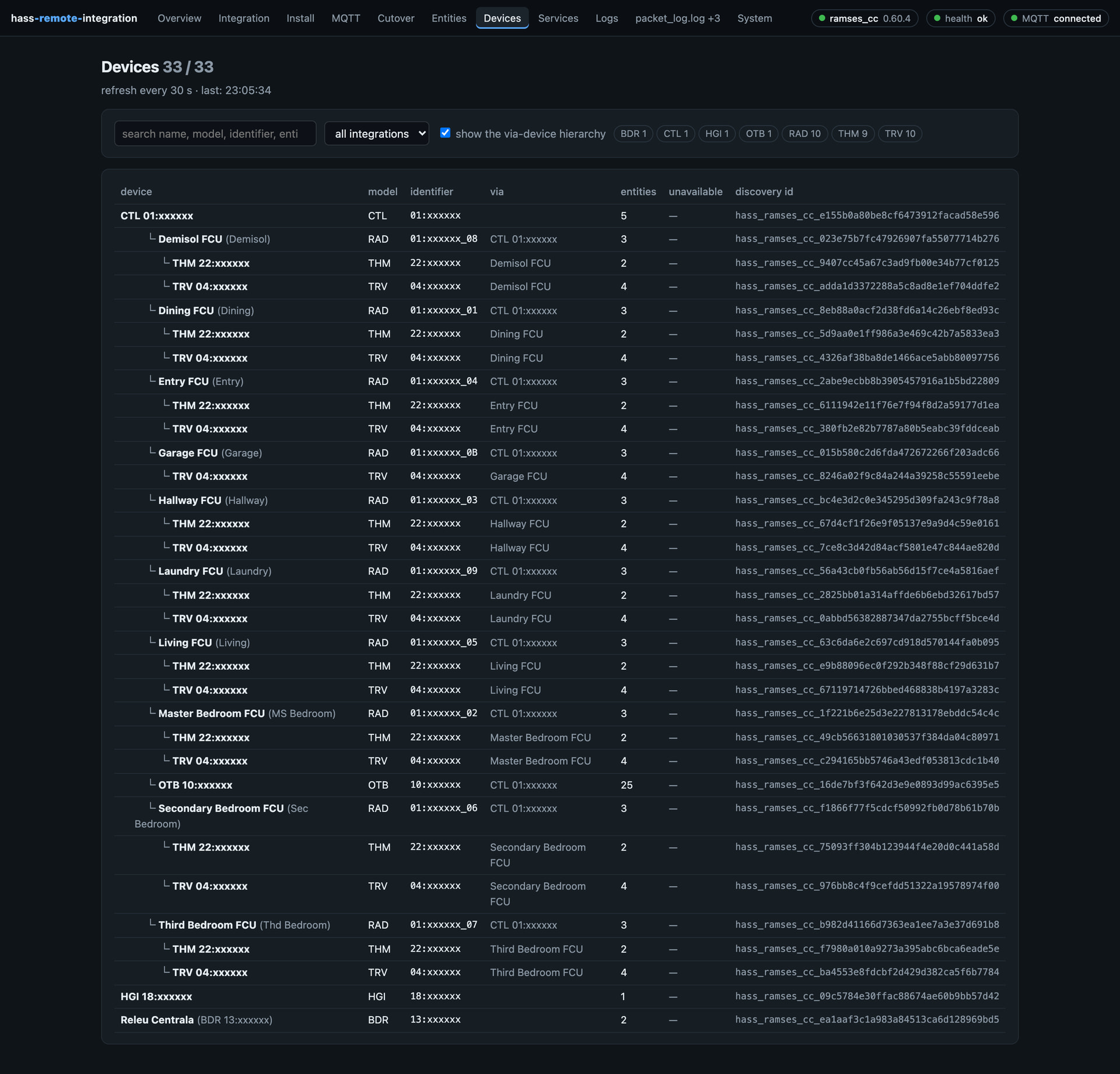

Devices. The controller, its zones, thermostats and radiator valves, grouped the way the integration reports them. These are the devices my main Home Assistant receives once discovery is on.

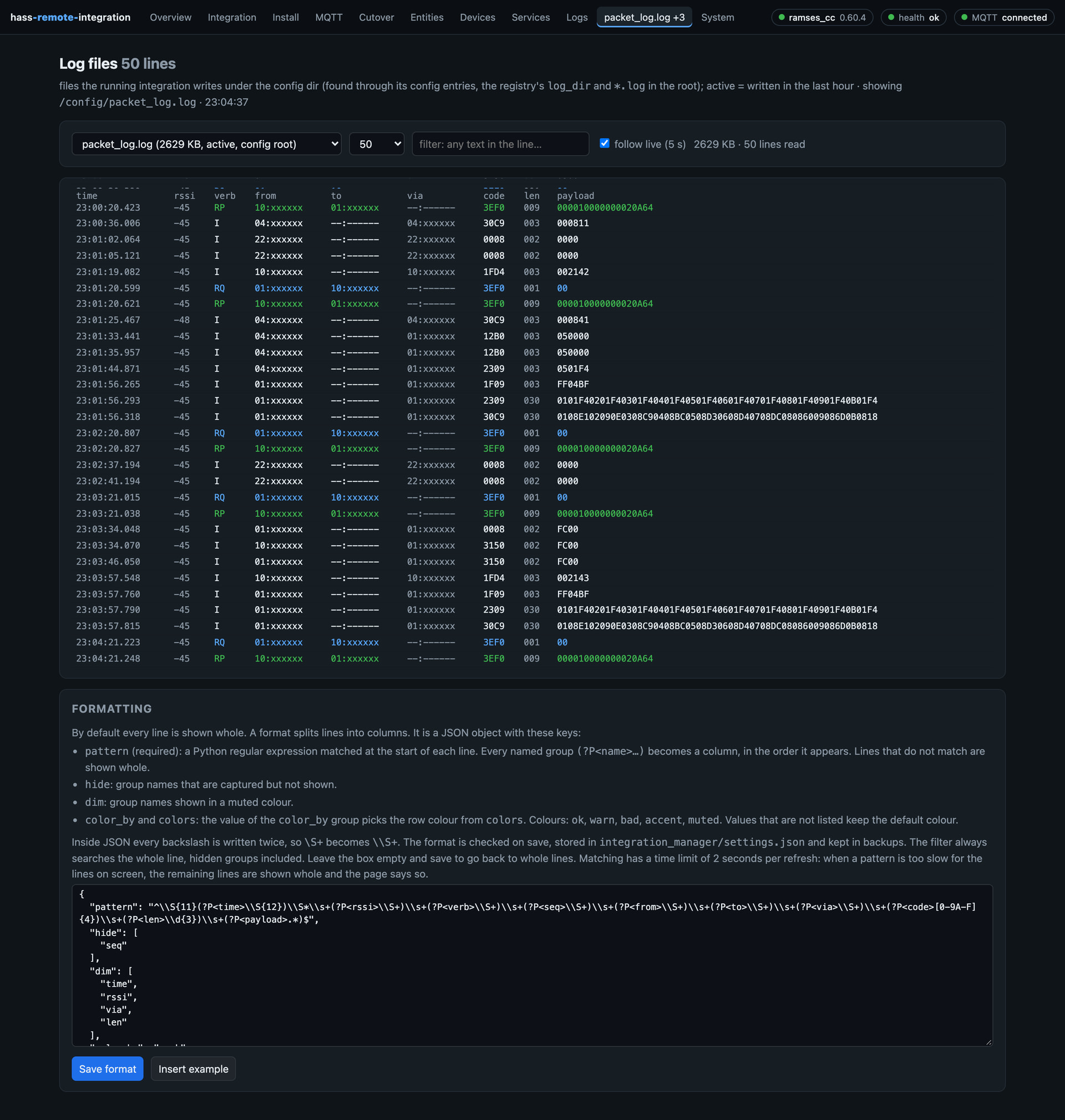

Log files. ramses_cc writes a packet log of the radio traffic. A small user-defined format splits each line into columns and colours requests and replies, so the traffic can be followed live in the browser.

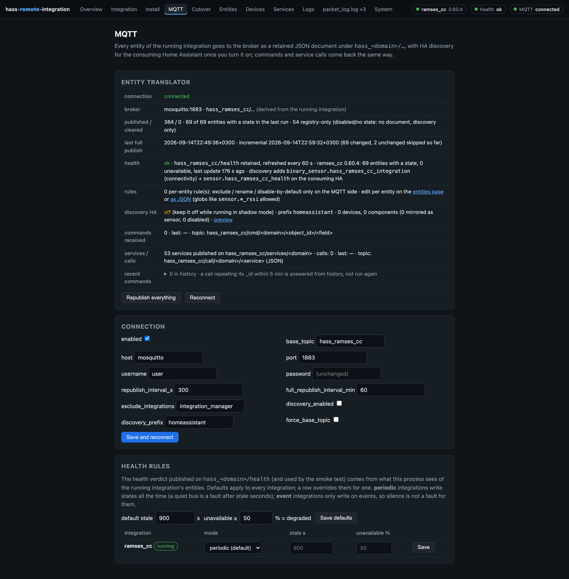

MQTT. Every entity is published as a retained JSON document, together with the service catalog and a health document. Commands and service calls come back over MQTT, and discovery is one checkbox away.

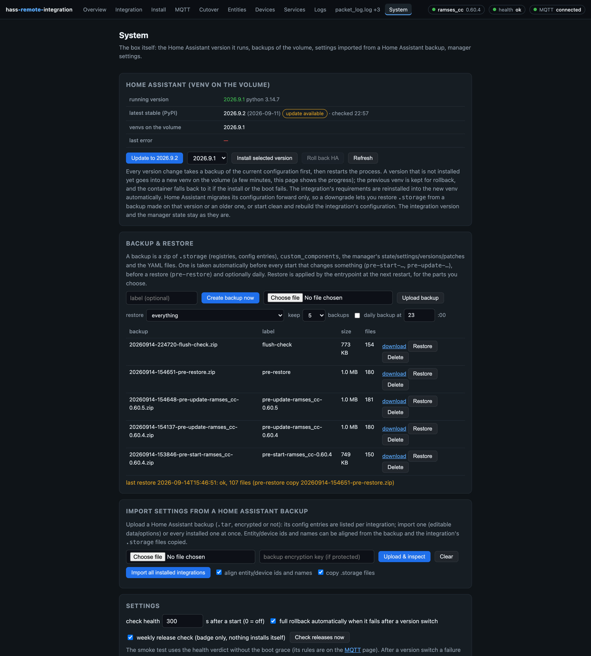

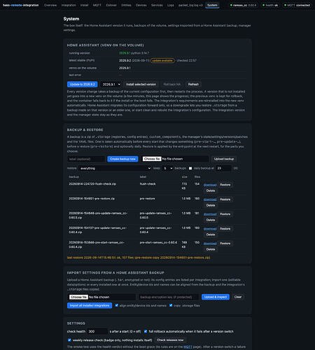

System. The Home Assistant version inside the container can be updated or rolled back from here, with a backup taken before every change. Backups can be downloaded and restored, fully or in parts.
