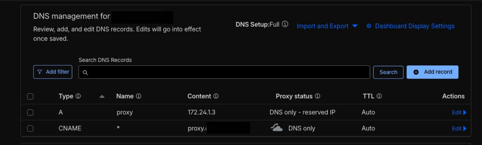

This is a silly little experiment with Nginx Proxy Manager and localhost i thought i’d share. NOTE: Articulation is not a strong point of mine.
I create 2 domain records as seen image
I install Nginx Proxy Manager (npm) as follows,

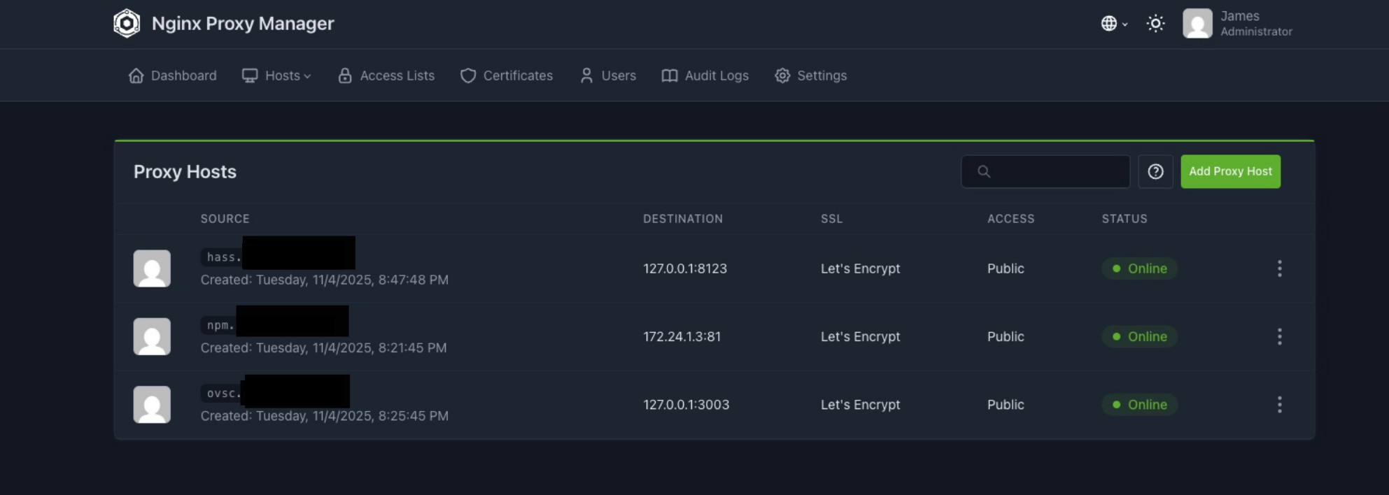

This is how i configured npm to access the domain name.
  1. I have VLC, Piper, and Cloudflare all setup using network_mode: ‘host’
  2. EMQX is a little different, i set the UI to ‘127.0.0.1:18083:18083’.
    I had ro set mqtt access to 172.24.1.3:1883:1883 for it to work properly.
