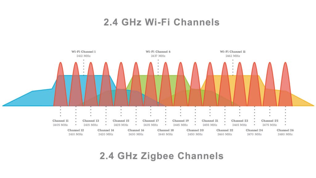

Will the matter and zb zbt-2 radios collide because they use the same spectrum slice? Do you have to adjust channels or something similar to de conflict wifi routers?
I’m not expert, but sure it is possible that there could be collision/interference with anything that uses a shared rf spectrum.
how bad that will affect things will be completely dependent on the local rf environment.
Personally I am running 2 bluetooth dongles, zigbee, thread, zwave, and a wifi AP in the same room and have not experienced any rf attributable issues.
It is not supported by the HA devs, but Sonoff is still doing it and supporting it.
They can and it is recommended to find different non-overlapping channels for the different radios.
Remember that multiPAN with Zigbee and Thread will always run the same frequency and therefore sort of interfere with each other.
Zigbee and Thread use same channel to frequency relation.
Also remember that these are mesh networks and mesh networks gets better, strong and more resilient with the number of devices.
Spreading your devices out over three different networks might be lowering the quality of all the networks, unless you go nuts and like 50 or more devices in to each network.
