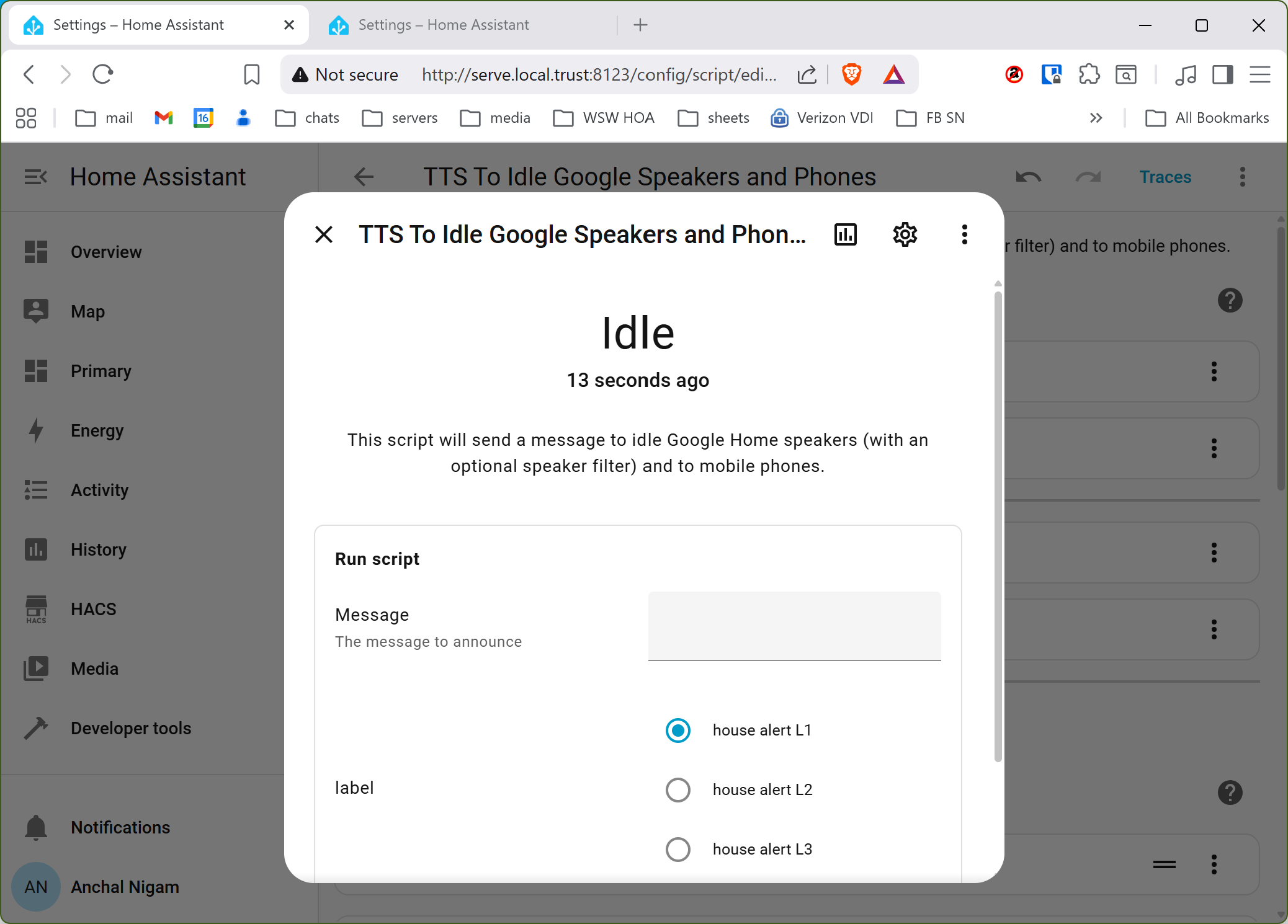

I have a script that has some fields. When I run the script from the script editor, sometimes it asks me for the field values, and sometimes it doesn’t. I cannot figure out why.
This is what I see when it does prompt for field values.
Below is my script YAML:
