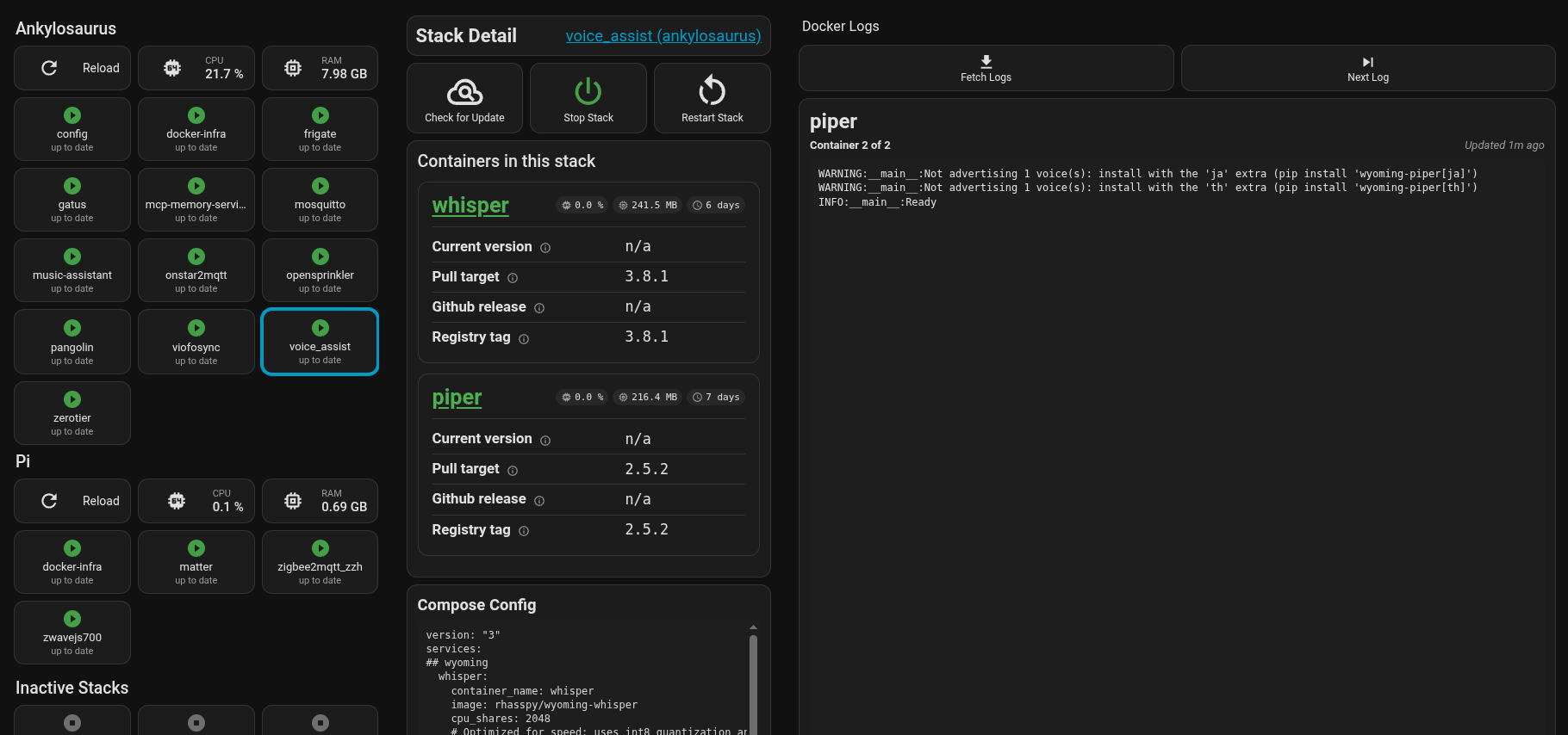

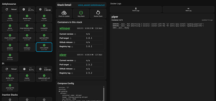

Dashboard
There’s an example dashboard in the repo — click a stack, see its compose config, its containers, current vs. available versions, and pull/restart controls, all without leaving the page. It needs a couple of HACS frontend cards (auto-entities, button-card) and one helper entity — details in the repo.
