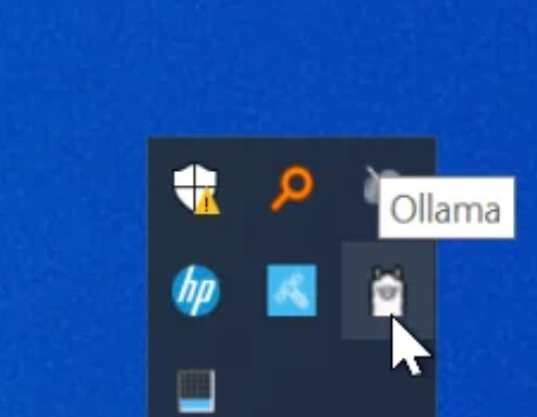

just got my local Ollama up and running on a PC, i think. for a moment it was working fine. i still see it on my Windows 10 machine.

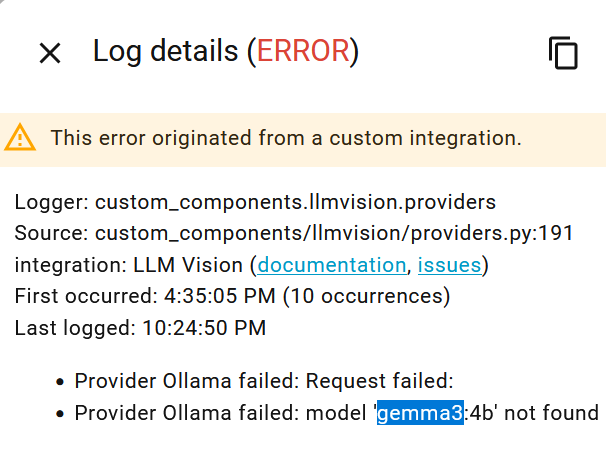

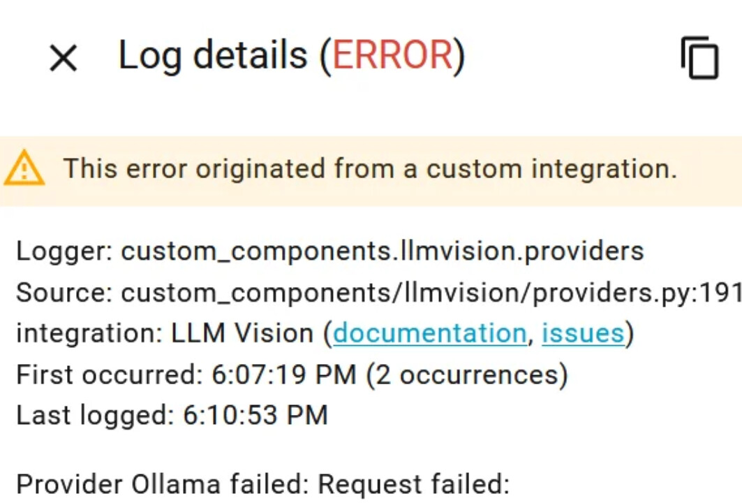

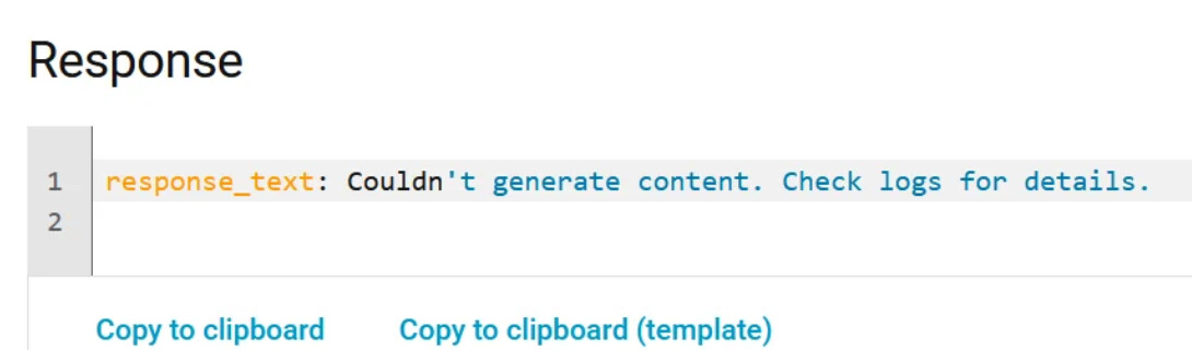

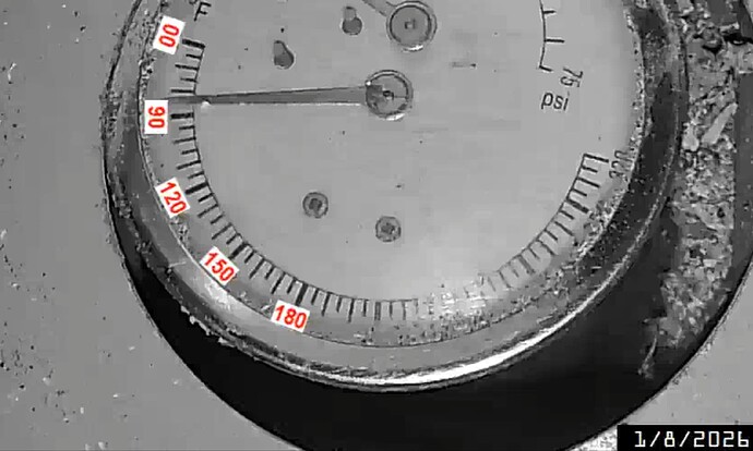

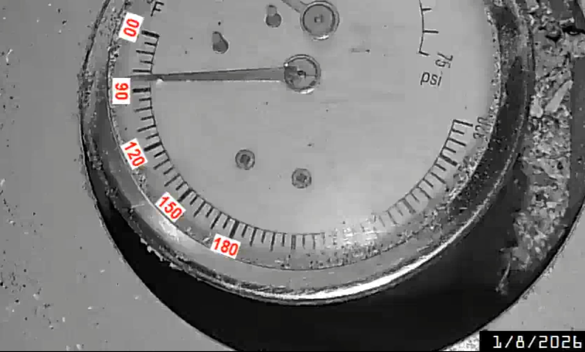

this is a snapshot of my house furnace temperature gauge for the heater in the basement. Google Gemini has no problem reading the gauge and outputting a number.
So I thought i can run qwen3-vl:2b model on Ollama locally on my i7 (7th gen intel). it works only once. this error comes up, from LLM Vision, no matter what i do. any idea why?
HA’s log:
Is the Ollama integration set up as Conversation Agent or AI Task?
Also, I think you want llmvision.data_analyzer

This error says the issue is on your ollama side. What’s the log output there also GPU type and Vram amount…

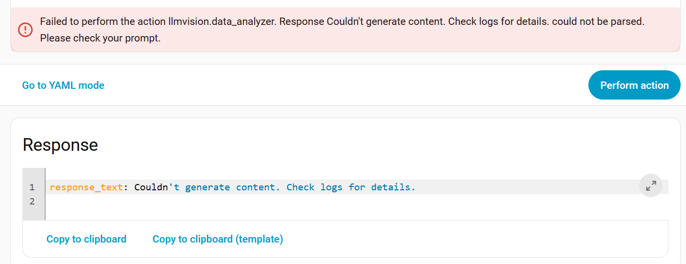

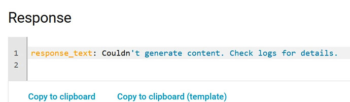

with data analyzer, it seems worse:
i dont know why it wants this model gemma3:4b log:
in LLM config, i set the model to be qwen…

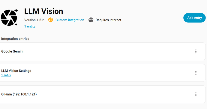

how to know if i set mine up as Conversation Agent or AI task? i dont see that option anywhere while adding the LLM Vision integration.

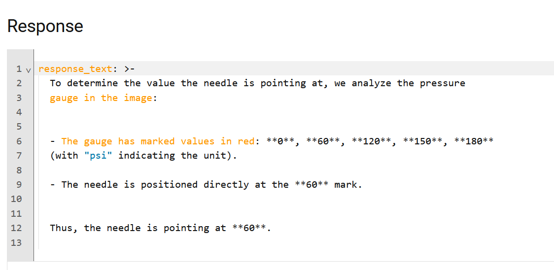

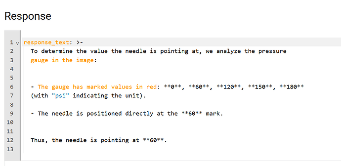

happy to say it is working, not perfect, but making progress than before!
i installed on a machine with a 3060 gpu and this is the response i got with
qwen3-vl:8b model
the value should be 90 but for some reason, Qwen gives 60.
is there any better model i should try?

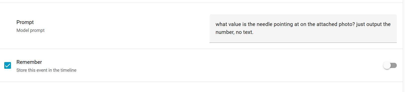

9

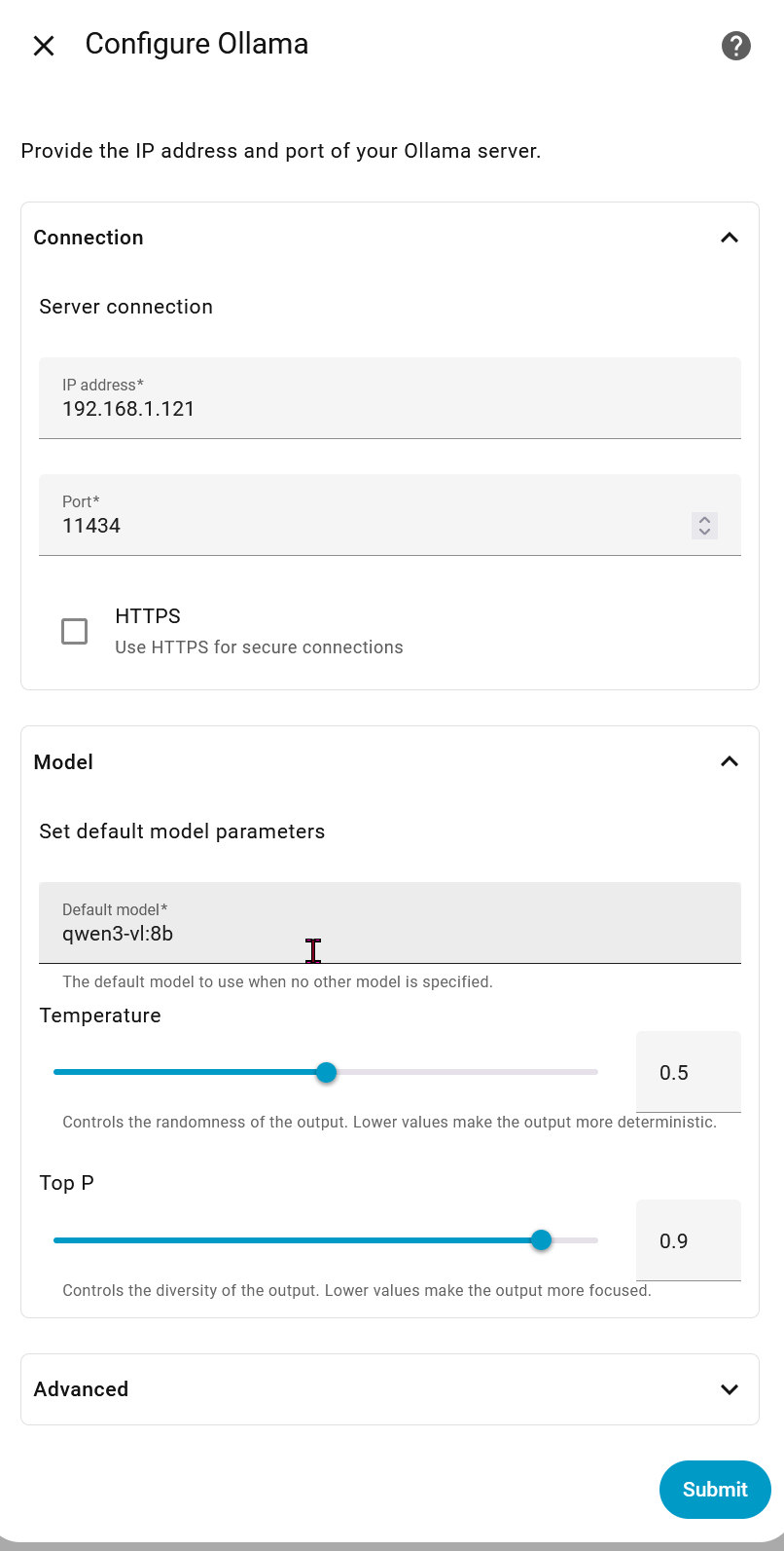

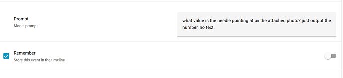

i dont know if it matters but once i change these 2 fields, i got correct answers for all the gauges in the house. WOW
