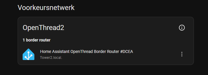

I formed a thread network, added it to Home Assistant, selected it as preferred network:

I’m wondering that you got this message, I fixed it with --primary-interface eno1.
But I’m unable to pair a IKEA MYGGBETT (my only Matter/Thread-device for now), running HA as container, ownbee/hass-otbr-docker connected with a Sonoff ZBDongle-E and home-assistant-libs/python-matter-server:stable.
Edit: It appears as child within in the otbr webinterface, but the Android HA App still tells me the connection to ha-thread-… is checked. Maybe some communication issue between otbr and matter container? But both run in host mode.
Edit2: Factory resetted MYGGBETT, connection worked now. :tada:
