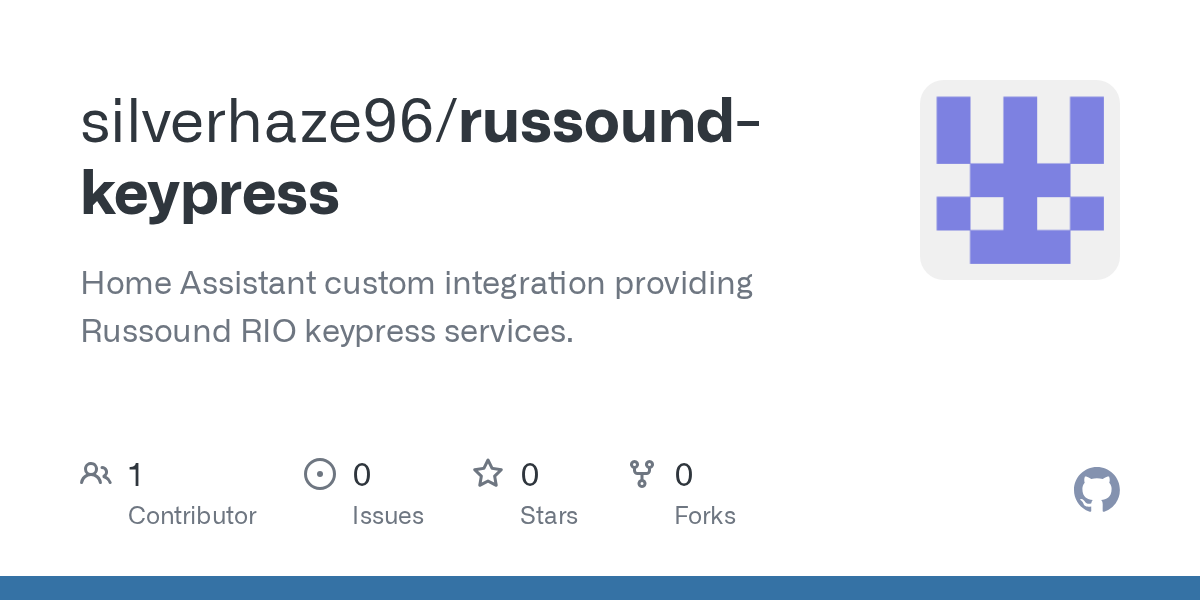

Installation
The integration can be installed manually by copying the custom_components/russound_keypress directory into the custom_components directory of your Home Assistant configuration.
GitHub repository:
After copying the files, restart Home Assistant.
