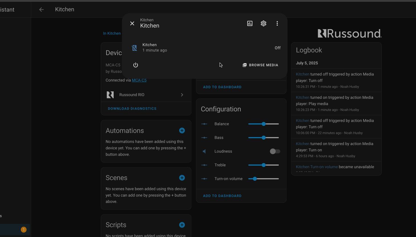

Iāve opened a pull-request to add media browsing for presets for Russound RIO. It should be in the next release (2025.8). This would allow you to browse the tuner presets right from the UI. Iāll work on improving controls for manually browsing tuner stations in the future.
Hereās an example of what that would like like:

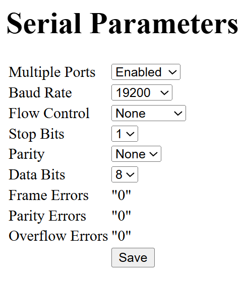

Iāve run into an issue where I canāt get the iTach to work at all. Using the same cable you bought too. Is there a port I need, Iāve tried 23 (telnet) and so far, nothing. (MCA-C5)
I figured it out, on the iTach, enable Multiple Ports:
In HA, for the port, use 4999.
