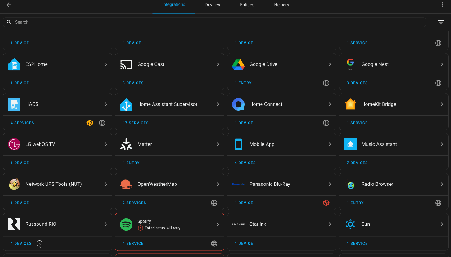

Ok sounds like by nature of the russound API i can’t use this system. I am using their entire ecosystem and it works great in the app - but I would have loved to have some automation in certain places. I can’t seem to change sources for each zone and I don’t know if we are talking about the same thing but I can’t turn a zone on and off and change volume. But picking its source doesn’t appear to be an entity in the integration. Not being able to control the sources and pick a station with some app is a big limitation as well. If I put the unit in source mode then what does that integration look like?

yes sorry I have 2 - mca-66 with 2 MBX-PRE as the the sources. I keep getting unavailable on this intergration and have to reload it in order to have control anyway so there is a bigger issue - but if I can’t do what I want the disconnection isn’t really that important.
Okay, and when you reload the integration and it connects, you are saying that you cannot change the volume or turn a zone on or off?
I’ve attached a GIF of what my install looks like for a zone. Can you compare and see where the differences may be?

You should see your two MBX-PREs as sources in the dropdown at a minimum and additional sources if you have any.
Ok I have that! I didn’t know it was in the next level so I can change sources thats a big + - Thanks
