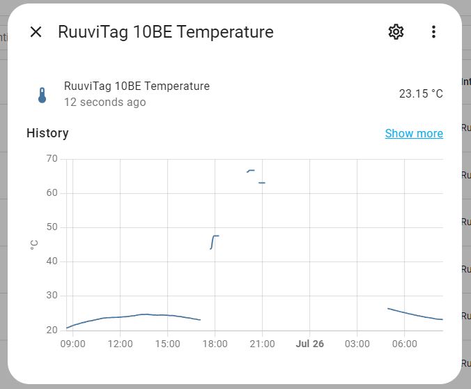

Hi
so the ruuvi was going good for about a week. Then I get this weird thing - the ruuvi shows the temperature at the correct setting but was is reported is not. See image
The temperature is correct at 64 degrees but the device states 24. ???
What goes on here?
