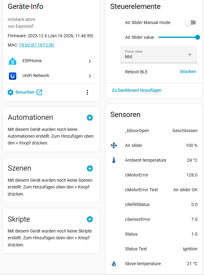

Thanks for sharing your project. Tested it with a M5 Atom Lite:

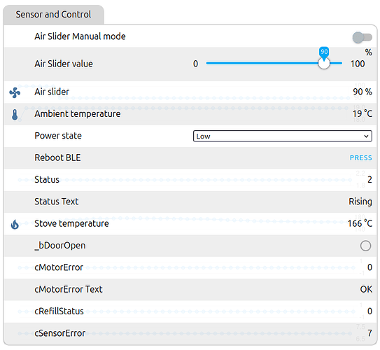

I also like to enable web server on every Esphome device:
web_server:
  port: 80
  version: 3
  local: true
  ota: false
