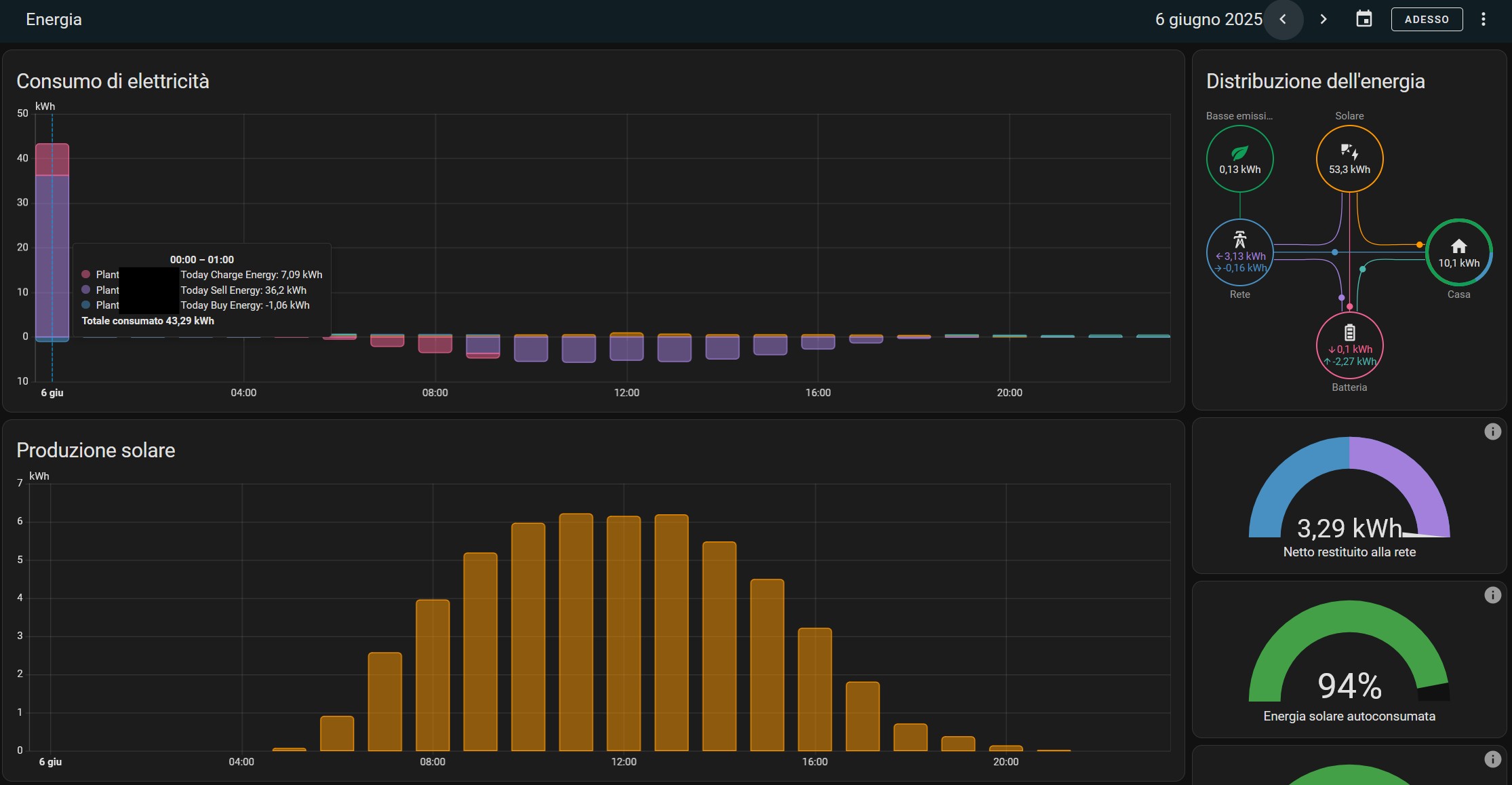

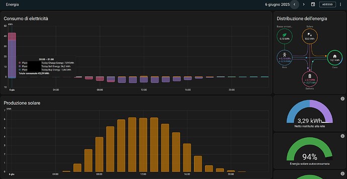

Hello, i’m using the Github elekeeper integration and it works great, the sensors values are right but i’m having some anomalies with spikes in values everyday around 00:00 or 00:05. maybe I’m using the vrong sensors in the energy configuration dashboard.
This are the anomalies in the dashboard
Whenever I remember I clean the values in the statistics but the anomaly apperars everyday around midnight

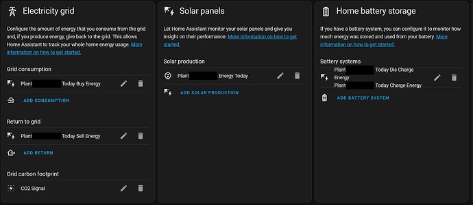

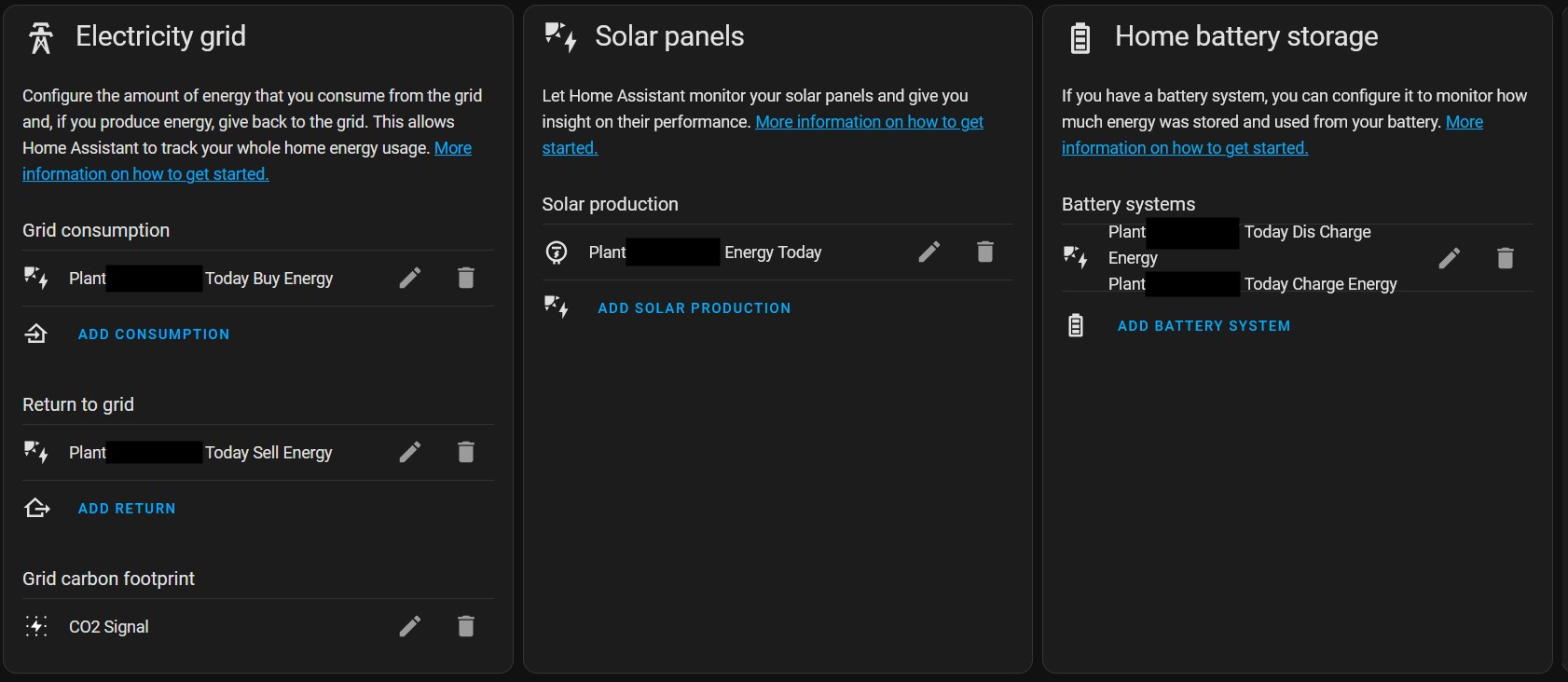

As new user i can only upload one image per post, I’ll try to upload a screen of my energy dashboard config, maybe i’m only using the wrong sensors in the dashboard.
Thanks in advance to everyone coul help to solve this little issue.
These are the sensors I’m using in the nergy dashboard.

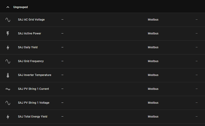

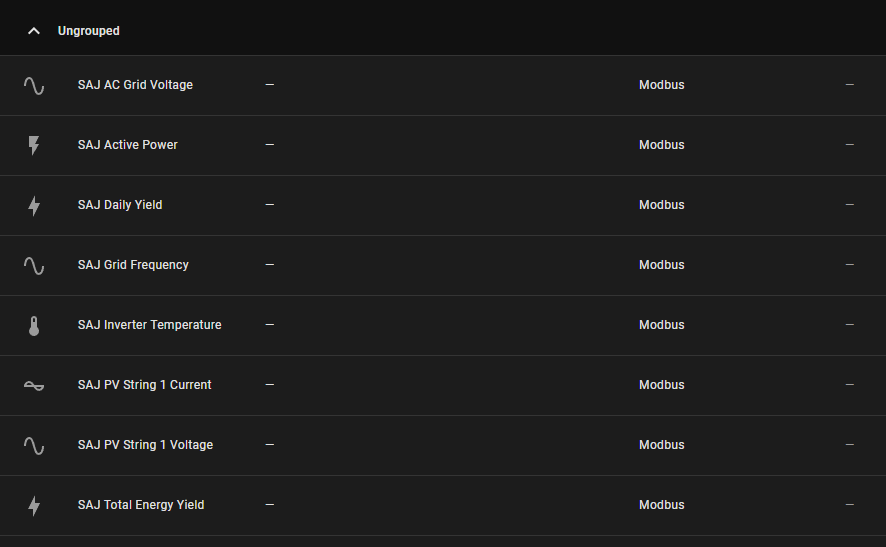

I used the following modbus configuration to get the AIO3 module working.
Got some help from Gemini after feeding it an export of all the addresses using modbus poll, seems to work well enough and values seem to make sense (and match the elekeeper app.)
The only thing I'm not convinced about is the temperature, 18C seems very low as the room is closer to 27 at the moment.
Hope this helps!
edit
OK, a lot of garbage values it seems. Grid Frequency varies from 30 to 60 Hz and the inverter voltage went up to 7000 degrees Celcius this morning.
I'll edit the config down below with what I can double check to be correct.
