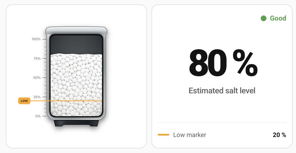

  • A dedicated Home Assistant dashboard card
  • Browser based firmware installation
The forecast runs on the device and learns from the normal decline in salt level. It takes some time to collect enough useful data, but after that it can give a better answer than just showing the current percentage.

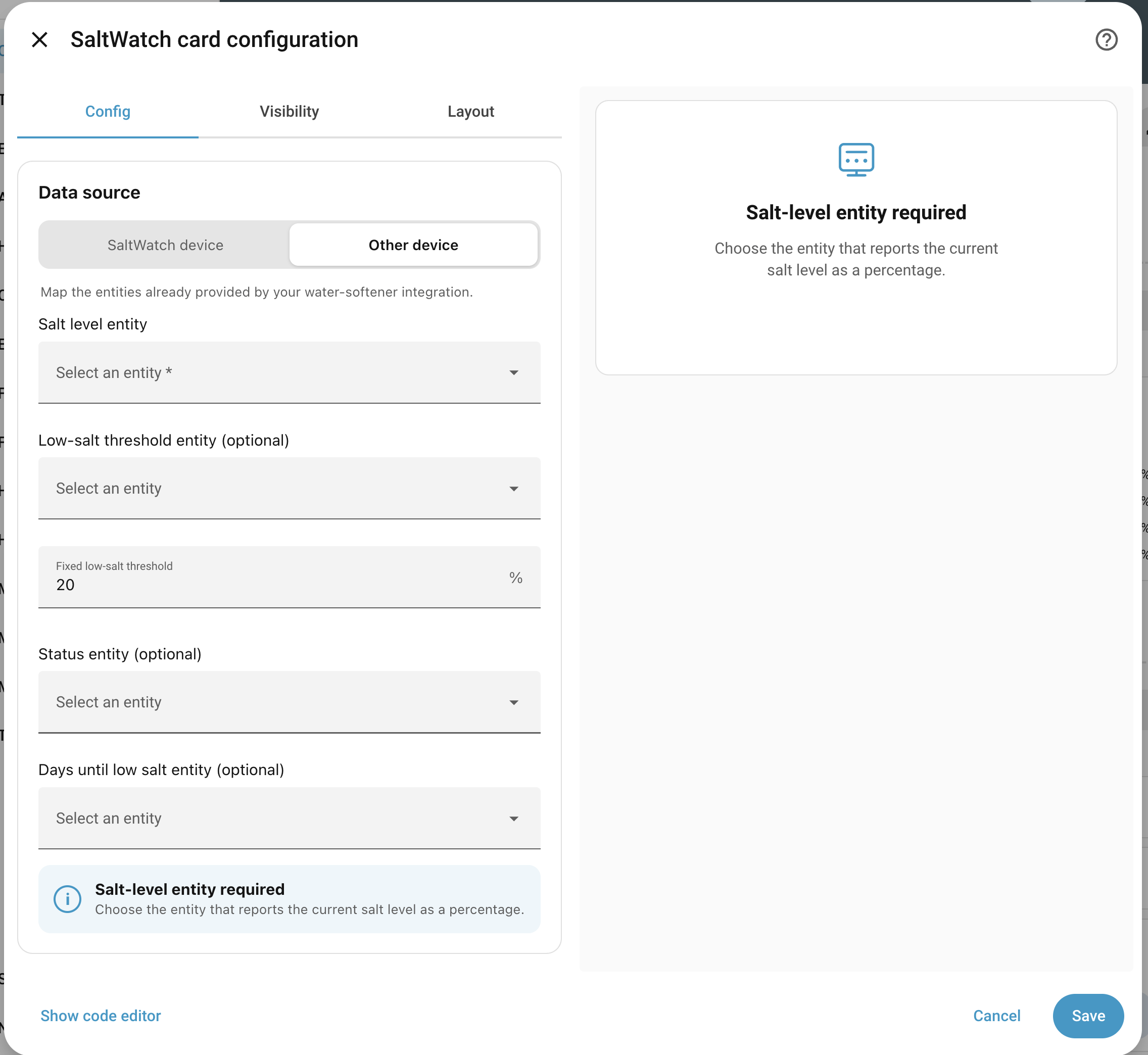

The card looks nice. I already have a Water Softener integrated into Home Assistant, that reports all this data, but that cannot be used with this card. Would be good if one could specify the individual entities for the different values, instead og being dependent on a fixed naming structure from the device id. My Softener is a Ecowater GREENLINE 40.
@briis Great news . This is now supported in SaltWatch Card v0.6.0!
Automatic discovery still works exactly as before when SaltWatch device is selected. The graphical editor now also has an Other device option, where you can map:
  • Salt level - required
  • Low-salt threshold - optional
  • Status - optional
  • Estimated days until low - optional
  • Forecast status and details - optional
If only a salt-level entity is available, the card still works and uses a configurable low threshold.
This should make the card usable with your EcoWater GREENLINE 40, provided its Home Assistant integration exposes a numeric salt-level entity between 0 and 100.
The update is available through HACS now. Thanks for the suggestion!

Now It works with my Softener. It does not have all the sensors but the display here is good enough for me.
Just one question: I have a Days until low salt sensor that reports right now 28d. Should that be visible anywhere? (I don’t use Forecast)
Also, would be nice to be able to translate the text like Low, Estimated salt level and low marker
@briis Your “Days until low salt” sensor the one currently reporting 28 days is exactly what the “Days until low salt entity (optional)” field is for. Select that sensor there, then choose either “Forecast only” or “Salt level and forecast” under Value display.
Regarding translation: do you mean that labels such as “Low,” “Estimated salt level,” “Low marker,” and “Good” should automatically appear in Danish according to your Home Assistant language setting?
