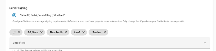

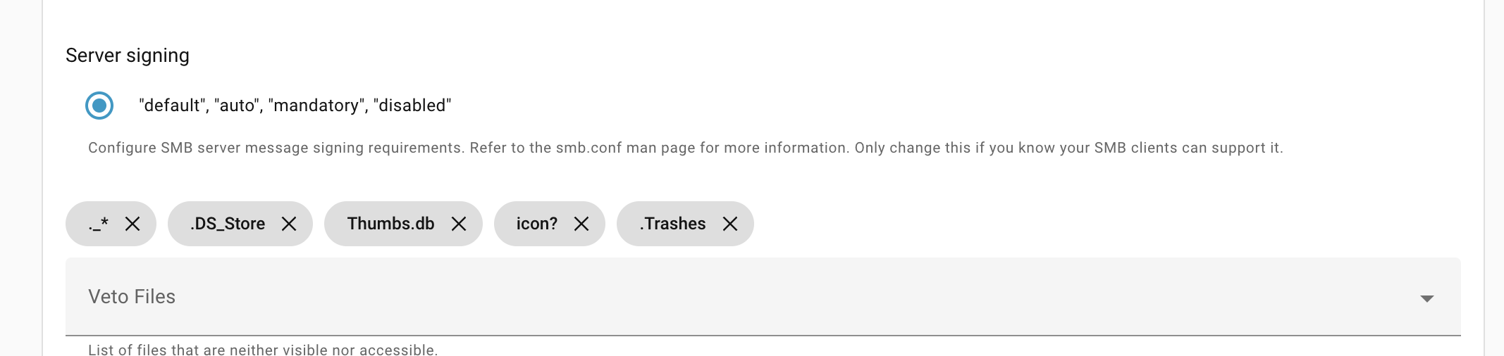

I uninstalled and re-installed the add on. When I attempted to update the configuration I received this message:
Failed to save add-on configuration, value must be one of ['"default", "auto", "mandatory", "disabled"']. Got {'username': 'homeassistant', 'password': 'issuance_lave9MISLIKE', 'workgroup': 'WORKGROUP', 'local_master': True, 'enabled_shares': ['addons', 'addon_configs', 'backup', 'config', 'media', 'share', 'ssl'], 'compatibility_mode': False, 'apple_compatibility_mode': True, 'server_signing': 'default', 'veto_files': ['._*', '.DS_Store', 'Thumbs.db', 'icon?', '.Trashes'], 'allow_hosts': ['10.0.0.0/8', '172.16.0.0/12', '192.168.0.0/16', '169.254.0.0/16', 'fe80::/10', 'fc00::/7', '192.168.1.0/24']}
I clicked the server signing button, but it still crashes.

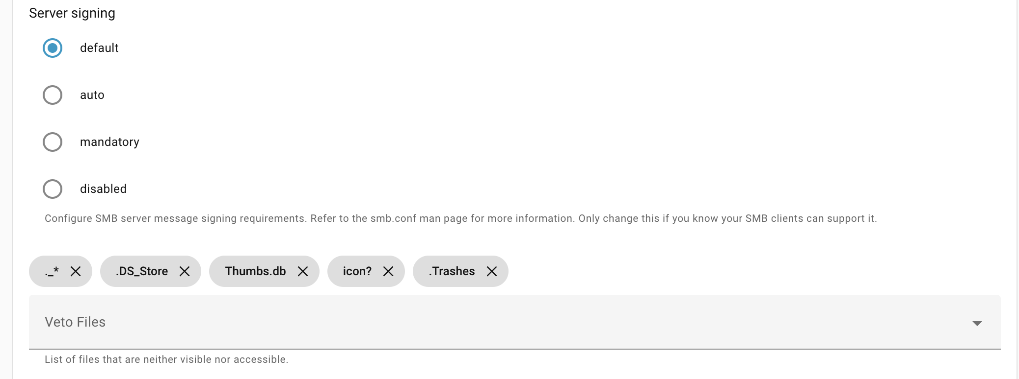

Awesome… just notified of 12.5.4 and installed, now running. Thanks for the response.
BTW… noticed the options have changed on the config page:
