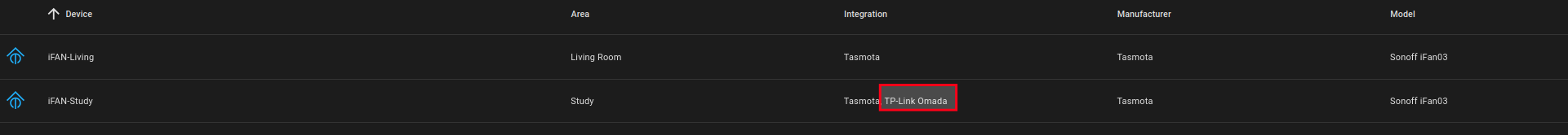

Hi All,
I have two Sonoff iFan3 controllers, both flashed with the latest Tasmota firmware, linked to the same wifi accesspoint and connected to the same MQTT system. I found that HA was listing one of them under two integrations. Any idea why that is and how I can ensure they will only be listed under the proper integration?
It seems that the TP-Link integration is somehow hijacking devices but no idea why.
Make sure SO19 is set to 0 or off so that the HA Tasmota integration works properly. That’s my guess. Auto-Discovery off.
I turned that off and had to remove the TP-link integration as well. The sonoff did not register under the TPLink intergration after I added that back so I guess we’re good. Thank you for the hint…
