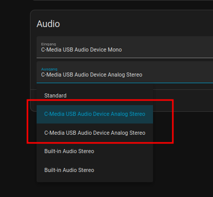

I have several USB audio devices connected to my Home Assistant.
These are all from the same vendor and therefore show the same name in the configuration screens.
Is there a way to change the names of the devices so that I can distinguish them in the configuration?

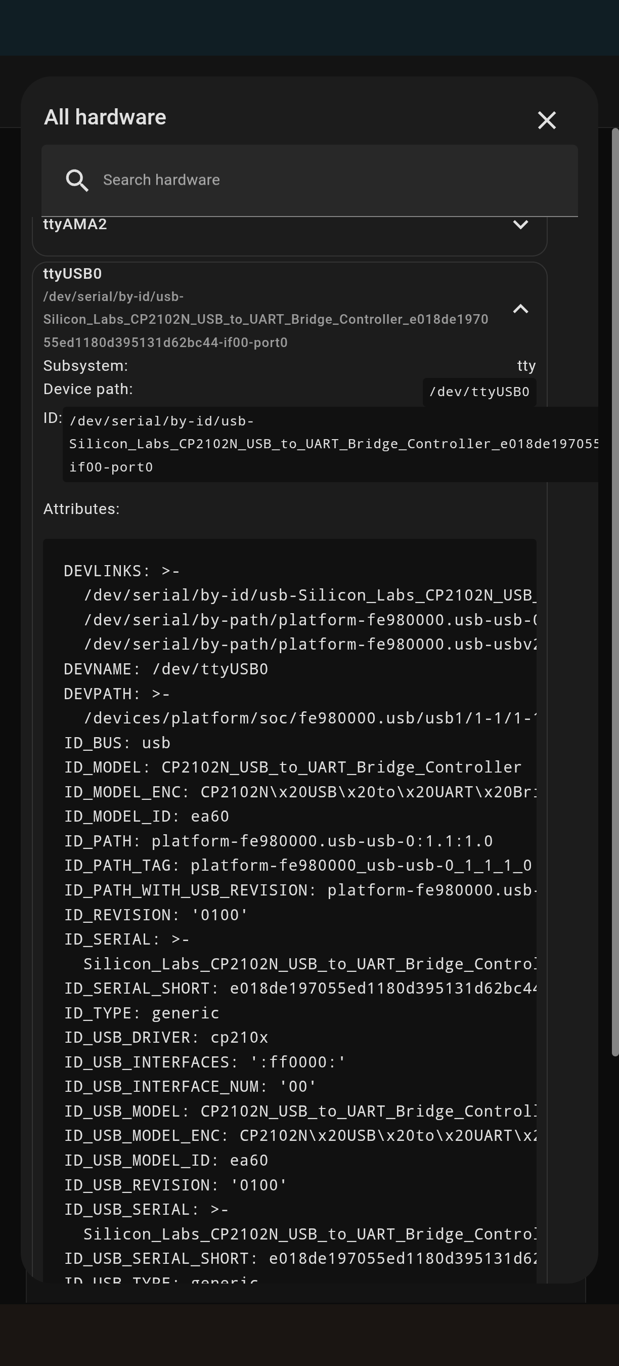

When I check the name of my ZWave stick, it is listed under ‘ID_SERIAL’, however I am not sure that will be enough.

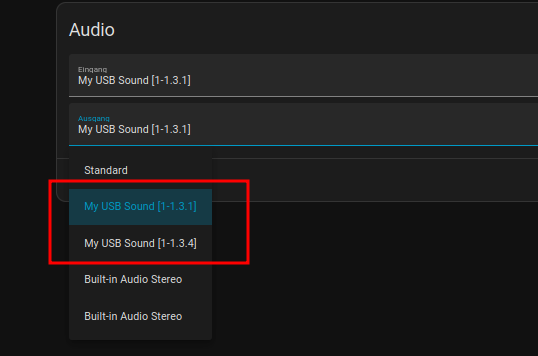

Hello, finally i was lucky! :wink:
The following udev rule does the trick, using ENV{SOUND_DESCRIPTION}:
SUBSYSTEM=="sound", ATTRS{idVendor}="0d8c", ATTRS{idProduct}=="000c", ENV{SOUND_DESCRIPTION}="My USB Sound [%b]"
With showing the USB Port number using %b.
