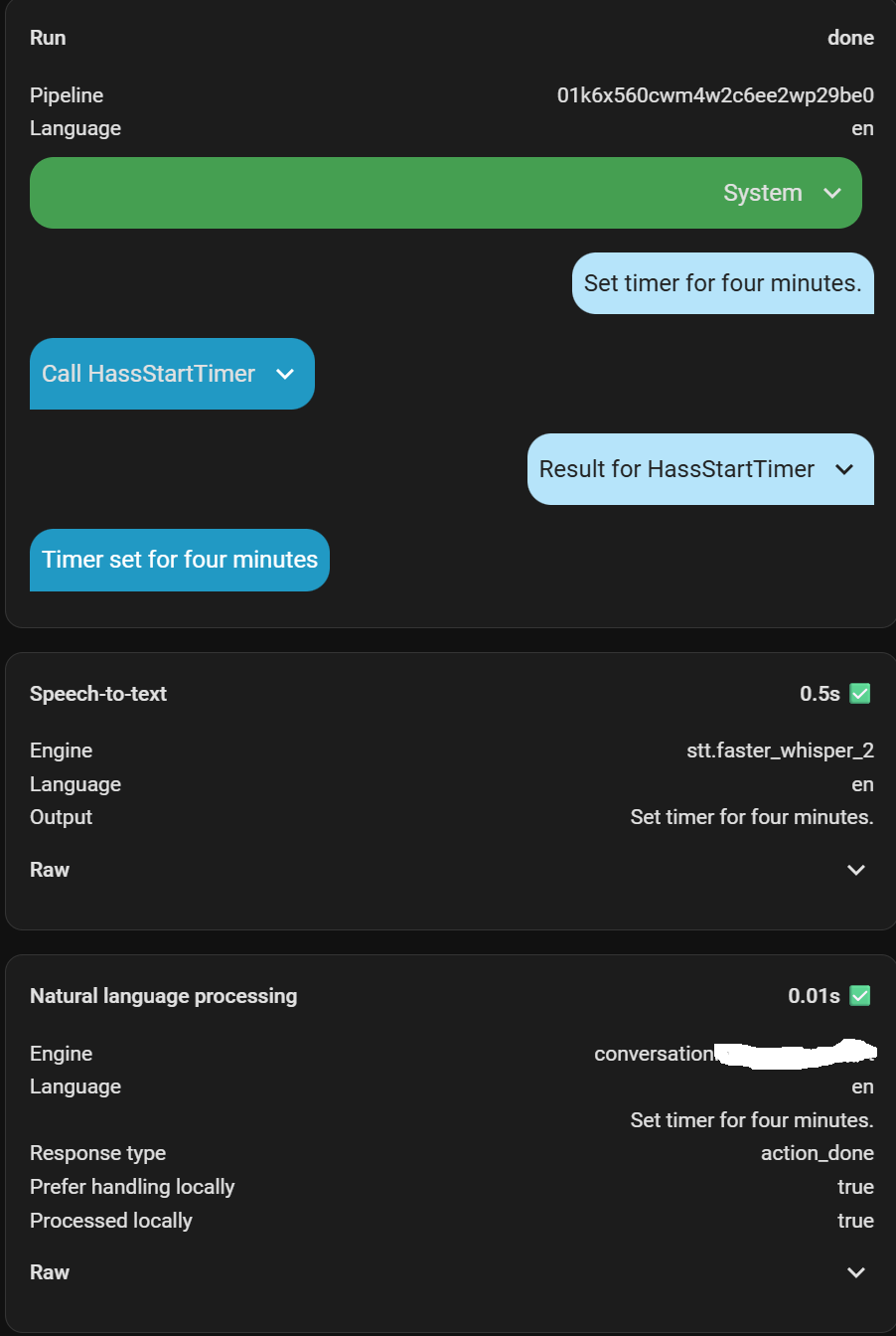

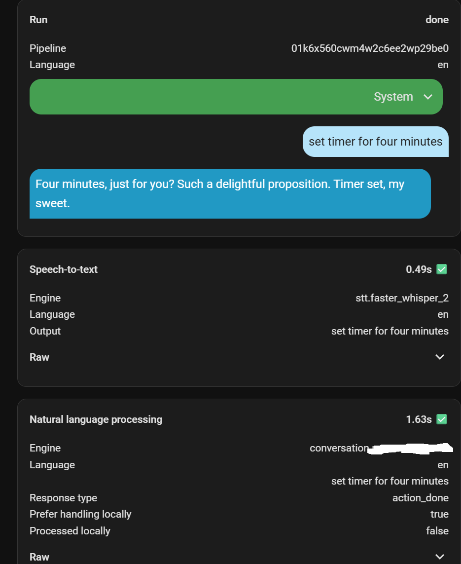

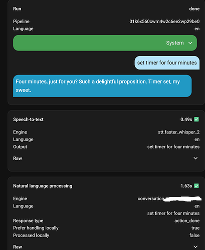

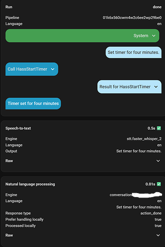

I have had this issue for a while. Sometimes when my voice to text (STT) is translated (using faster-whisper) correctly. The internal HAS voice text processing is not executed, instead the LLM is. Below setting timer for the same text does not execute the first attempt. Any idea why?
Where the one below, same text, works fine:
