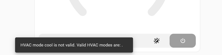

In both HAOS systems climate_ip is installed, the configuration file has its dedicated section, I can see the temperatures but pressing the various bottons (cool, heat, fan…) either does nothing or gives the error:
HVAC mode cool is not valid. Valid HVAC modes are: .
Another symptoms is when I change the temperature or other settings and I got this message:
immagine
This is something completely different.
This happens on mine as well, you need to set modes correctly.

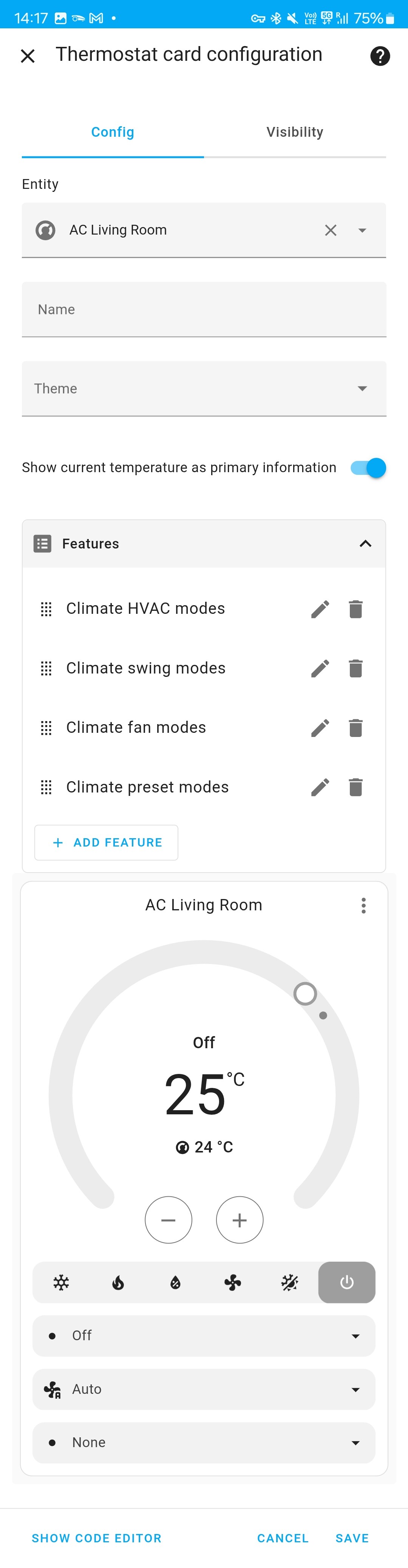

Edit the card and add the features like this and set the modes.
Otherwise you can post the state attributes of the entity, to see what are the modes on the AC. (Developer tools/States/Set state and select the climate entity and it will show the state attribues.)
By the way, is it the built in Thermostat card or something custom similar?
