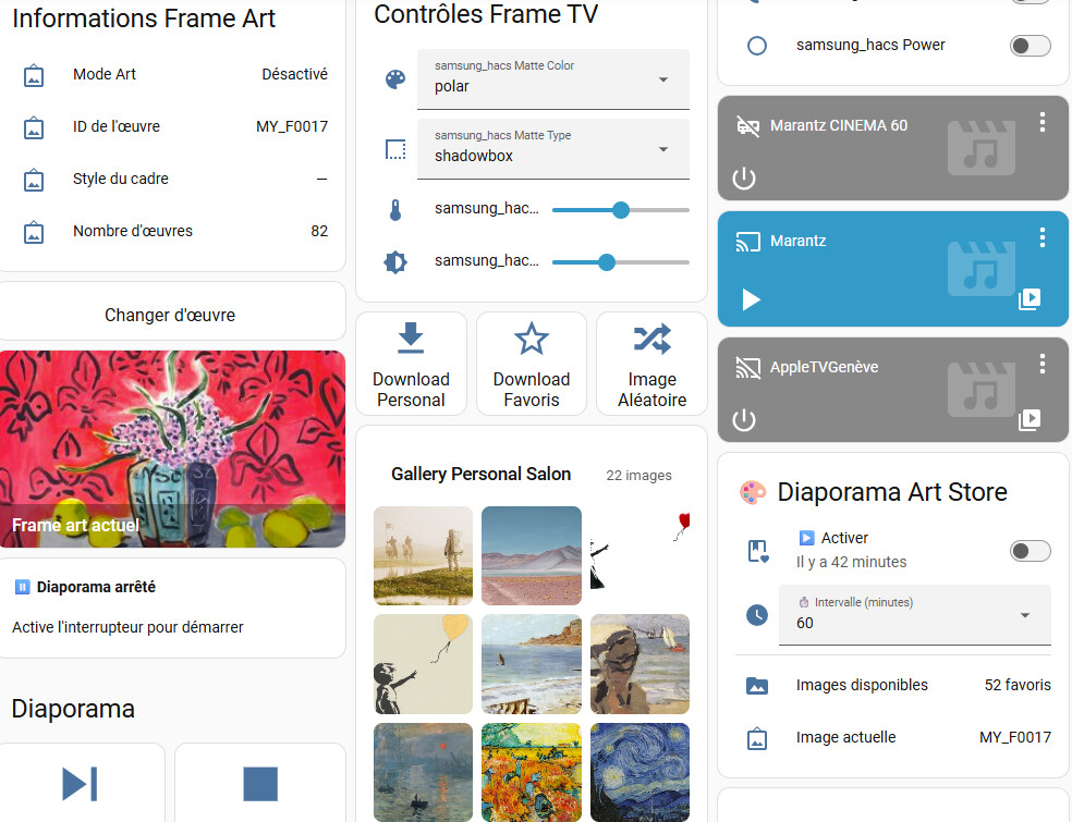

Thanks - I’m still kind of unclear - how do I take a gallery folder, push the whole folder to the TV and then have it automatically rotate through the folder?
examples/frame_art/.
Good question — the confusing bit is that the TV doesn’t keep your folder structure. When you upload images they all land in My Photos and the TV gives each one its own id (MY_F0123). So “push a folder and rotate it” really splits in two:
1. You just want everything you uploaded to rotate (the usual case)
Push the whole folder in one call:
action: samsungtv_smart.art_upload_batch
  entity_id: media_player.your_frame
  folder: /config/www/frame_upload     # any folder of jpg/png
Re-run it whenever you add images — it only uploads new/changed files (it keeps a hidden per-folder record), so you can just drop more in and call it again.
Then let the TV rotate them itself, no automation needed:
action: samsungtv_smart.art_set_slideshow
  duration: 15min
  shuffle: true
  category_id: 2        # 2 = My Photos, 4 = Favourites, 8 = Art Store
That’s the whole thing for 200–300 photos: one upload, one slideshow call, and the TV cycles through all of them on its own.
2. You want selectable theme sets (landscapes / abstract / …)
The TV has no sub-folders, so the grouping has to live in Home Assistant. Upload each theme folder separately — art_upload_batch returns the ids it uploaded, so each theme’s ids can be captured:
  folder: /config/www/frame_themes/landscapes
response_variable: result   # result.content_ids = this theme's ids
Then turn the TV’s own slideshow off so the two don’t fight, and rotate the selected theme yourself with the input_select.frame_theme + every-15-minutes art_select_image automation I posted above.
There’s a ready-made version of all of this under examples/frame_art/ — configuration.yaml (the theme sensors), scripts.yaml, automations.yaml and lovelace-folder-gallery.yaml wire up exactly the “folder → theme → rotate” flow, with a dashboard to pick a theme.
