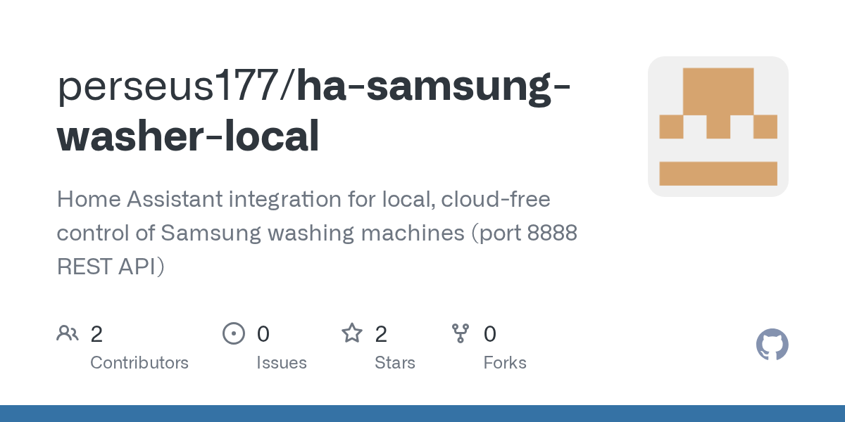

Port 8888 suggests a different method, which is token based but quite similar to the CoAP one regarding structure.
@perseus177, started to work on solution for that for his washer with success. Repo here:
There are a set of tools to get the token in the repo. I am not sure, if there is a smart control button for your AC, or something similar, that should be turned on, and it should answer the token requests, if no button like that, then turn it off, and then turn it on, usually after turning on the device emits the token, at least that is how it works with the 2878 versions.
There is an issue on localthings to get the 8888 version implemented in the same integration due to the similarity.
