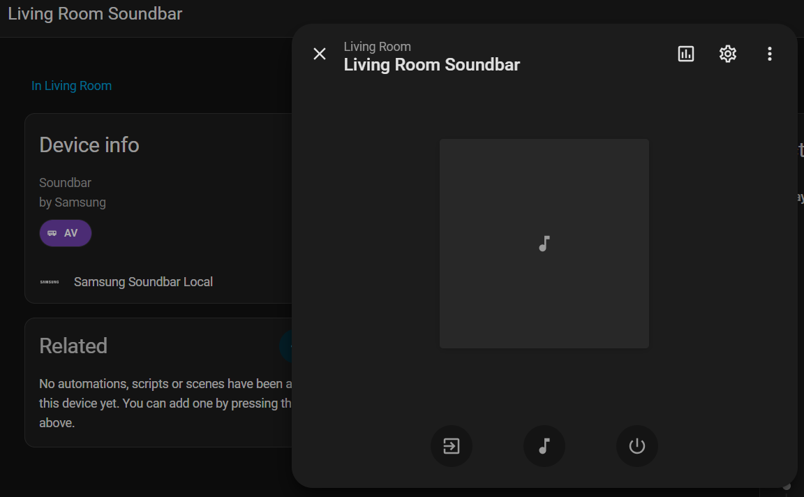

Hi! While integrating my HW-S60D soundbar, I discovered there was no existing integration using the local LAN control protocol—so I built one.
It should be compatible with the following models: HW-Q990D · HW-Q930D · HW-Q800D · HW-QS730D · HW-S800D · HW-S801D · HW-S700D · HW-S60D · HW-S61D · HW-LS60D.
The integration is available via HACS.
GitHub repository: GitHub - ZtF/hass-samsung-soundbar-local
