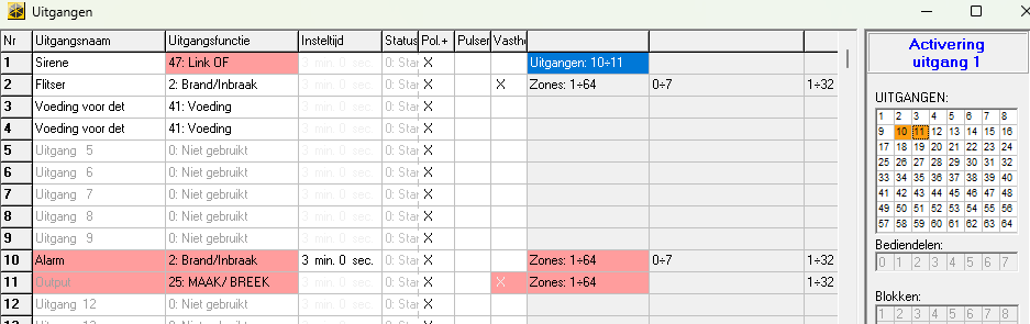

I have a question. I have on output in my satel siren outdoor. I can add it to intergration and use examle when from other sensor in HA CO2 is bigger and play sound by this siren ? How i can add siren to integration ?
You should be able to add a switchable output in Home Assistant, those will show up as switches which you can then use in automations.
1 tricky part there is you need to make sure to have configured a code in the integration. Go to the integration:
Open your Home Assistant instance and show an integration.
From there, click the gear icon on the config entry, there you can configure the code (That should be the access code set in dloadx)
But what is this code? To integration ?
ANd where in DLOADX i setup it ?
To use an output in the Integra you will need to use a code that is allowed to switch outputs.
So setup a user in the Integra that has permission to switch outputs.
So Tom means you have to put the pin code in the integration so its able to use that for switching purposes.
As far as making the output switchable, you will need to change the siren output function to an OR output, and link the original function to that (via a not used output number) and another output that has either function 24: Pulse or 25: Make/Brake.
In this case output 10 will trigger like normal if the siren needs to go off.
And output 11 will be the one you can switch from HA.
Since its an OR link both of them can trigger the siren.
