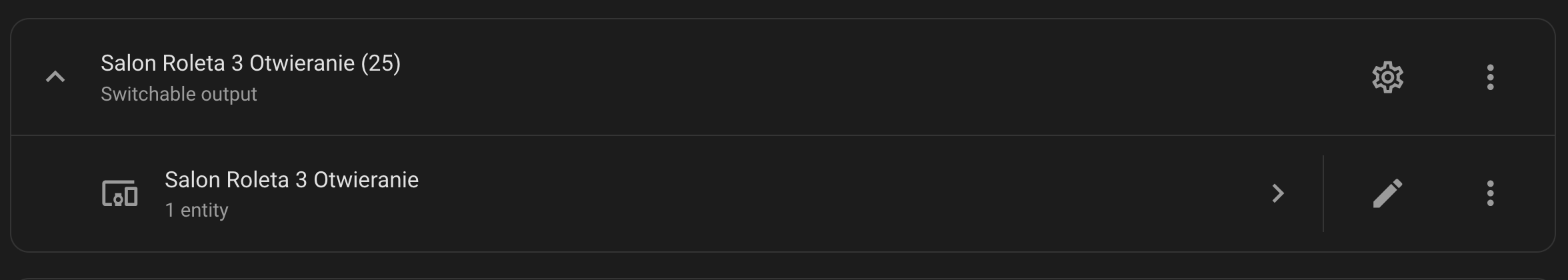

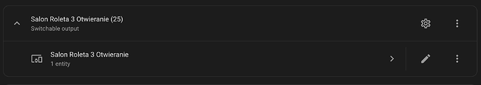

      "01KBSH4D26WZ6M73AD023T4SJX": {
        "data": {
          "name": "Salon Roleta 3 Otwieranie",
          "switchable_output_number": 25
        "subentry_id": "01KBSH4D26WZ6M73AD023T4SJX",
        "subentry_type": "switchable_output",
        "title": "Salon Roleta 3 Otwieranie (25)",
        "unique_id": "switchable_output_25"
