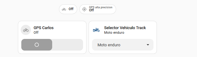

Helpers
Settings → Helpers:
  • input_boolean.away_track — Toggle (“Rider is out”)
  • input_select.vehicle_type — Dropdown (Bike / Motorbike / Enduro)

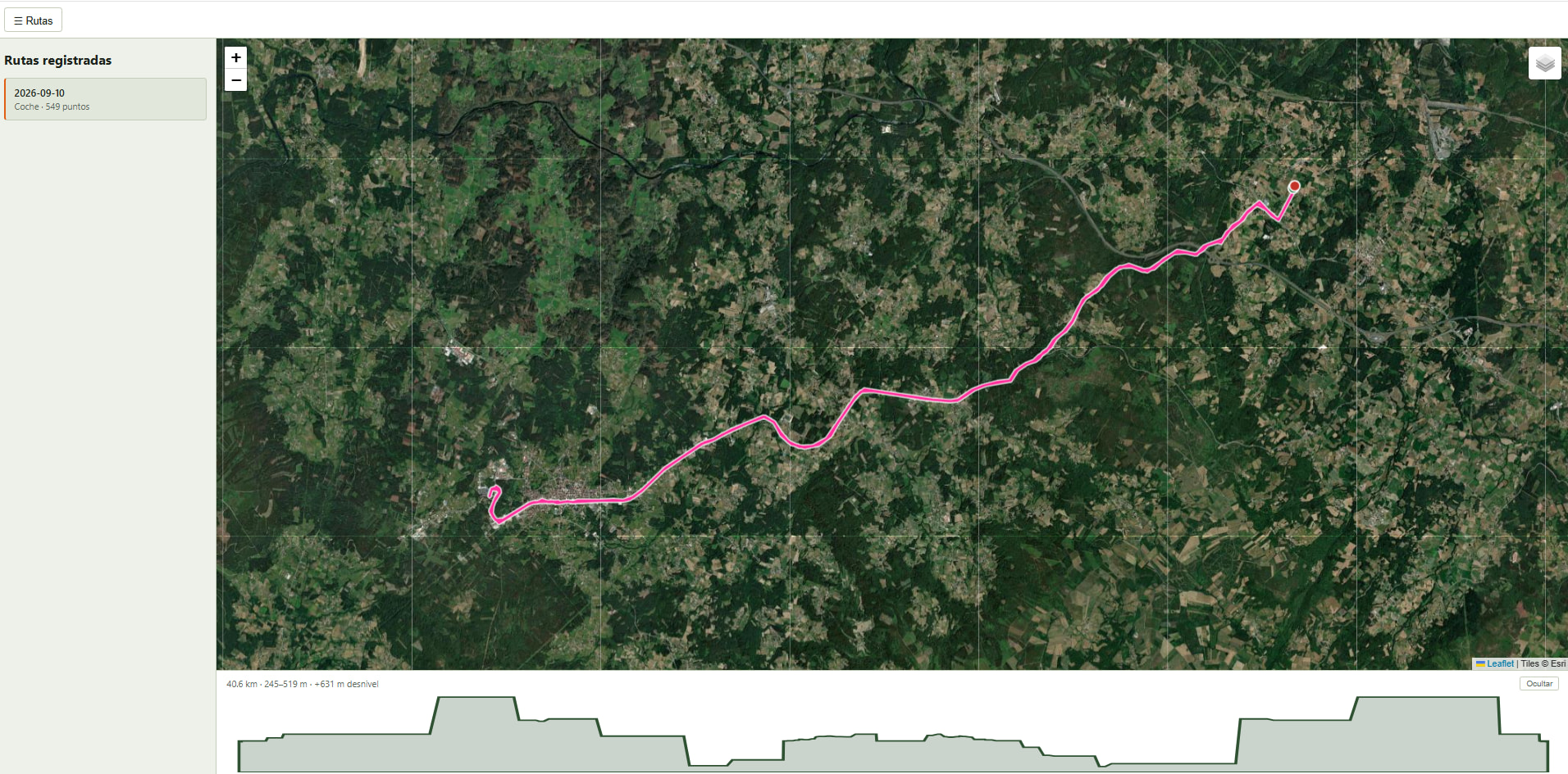

The web viewer
The GPX files above are permanent, but a folder full of them isn’t much fun to browse. This is a single static HTML file, no backend of its own — it reads index.json (the running index the script above maintains) to list rides, and on selecting one, fetches its .gpx and draws it with Leaflet.
Read this before you expose it
/config/www/ (served at /local/...) does not go through Home Assistant’s authentication — that’s by design, and always has been. If your instance is reachable from the internet (a tunnel, reverse proxy, or Nabu Casa Remote UI), anyone with the URL can see your GPX rides with no login at all. See the security section below before exposing this.
What it includes:
  • Three switchable base layers: streets, satellite, topographic.
  • A hand-drawn SVG elevation profile (cumulative distance via the Haversine formula), with a button to collapse it.
  • A collapsible route list on narrow screens — built without position: fixed, because that breaks when the page is opened embedded as an iframe/webview from inside the Home Assistant app itself.

<script src="https://unpkg.com/[email protected]/dist/leaflet.js"></script>
<script>
  const map = L.map('map').setView([YOUR_LAT, YOUR_LON], 15);
  const streets = L.tileLayer('https://server.arcgisonline.com/ArcGIS/rest/services/World_Street_Map/MapServer/tile/{z}/{y}/{x}', {
    attribution: 'Tiles &copy; Esri',
    maxZoom: 19
  const satellite = L.tileLayer('https://server.arcgisonline.com/ArcGIS/rest/services/World_Imagery/MapServer/tile/{z}/{y}/{x}', {
    maxZoom: 19
  const topo = L.tileLayer('https://{s}.tile.opentopomap.org/{z}/{x}/{y}.png', {
    attribution: 'Map data: &copy; OpenStreetMap contributors, SRTM | Map style: &copy; OpenTopoMap',
    maxZoom: 17
  streets.addTo(map);
  L.control.layers({
    'Streets': streets,
    'Satellite': satellite,
    'Topographic': topo
  }).addTo(map);
  let currentLayer = null;
  document.getElementById('toggle-rides').addEventListener('click', () => {
    document.getElementById('content').classList.toggle('collapsed');
    setTimeout(() => map.invalidateSize(), 160);
  function closeRidesOnMobile(){
    if (window.innerWidth <= 700) {
      document.getElementById('content').classList.add('collapsed');
  async function loadIndex(){
    const list = document.getElementById('list');
    try {
      const resp = await fetch('index.json?v=' + Date.now(), {cache: 'no-store'});
      if (!resp.ok) throw new Error('no index.json yet');
      const rides = await resp.json();
      if (!rides.length){
        list.innerHTML = '<p class="empty">No rides recorded yet.</p>';
        return;
      list.innerHTML = '';
      rides.forEach((ride, i) => {
        const btn = document.createElement('button');
        btn.className = 'ride-card';
        btn.innerHTML = `
          <span class="date">${ride.date}</span>
          <span class="detail">${ride.vehicle || 'unknown vehicle'} · ${ride.num_points} points</span>
        btn.addEventListener('click', () => {
          document.querySelectorAll('.ride-card').forEach(c => c.classList.remove('active'));
          btn.classList.add('active');
          showRide(ride.gpx);
          closeRidesOnMobile();
        list.appendChild(btn);
        if (i === 0) { btn.classList.add('active'); showRide(ride.gpx); }
    } catch (err) {
  function haversine(a, b){
    const R = 6371000, toRad = d => d*Math.PI/180;
    const dLat = toRad(b[0]-a[0]), dLon = toRad(b[1]-a[1]);
    const la1 = toRad(a[0]), la2 = toRad(b[0]);
    const h = Math.sin(dLat/2)**2 + Math.cos(la1)*Math.cos(la2)*Math.sin(dLon/2)**2;
    return 2*R*Math.asin(Math.sqrt(h));
  function drawElevation(points){
    const svg = document.getElementById('elevation-chart');
    const summary = document.getElementById('elevation-summary');
    svg.innerHTML = '';
    const withEle = points.filter(p => p[2] !== null && !isNaN(p[2]));
    if (withEle.length < 2){
      summary.textContent = 'No elevation data for this ride';
      return;
    let dist = 0;
    const dists = [0];
    for (let i = 1; i < points.length; i++){
      dist += haversine(points[i-1], points[i]);
      dists.push(dist);
    const eles = points.map(p => p[2]);
    const minE = Math.min(...withEle.map(p => p[2]));
    const maxE = Math.max(...withEle.map(p => p[2]));
    const spanE = Math.max(maxE - minE, 1);
    const w = 900, h = 110, pad = 8;
    const x = i => pad + (dists[i]/dist) * (w - 2*pad);
    const y = e => h - pad - ((e - minE)/spanE) * (h - 2*pad);
    let area = `M ${x(0)} ${h}`;
    points.forEach((p, i) => { area += ` L ${x(i)} ${y(p[2] ?? minE)}`; });
    area += ` L ${x(points.length-1)} ${h} Z`;
    const svgns = 'http://www.w3.org/2000/svg';
    const path = document.createElementNS(svgns, 'path');
    path.setAttribute('d', area);
    path.setAttribute('fill', 'rgba(47,82,51,0.25)');
    path.setAttribute('stroke', 'var(--moss)');
    path.setAttribute('stroke-width', '2');
    svg.appendChild(path);
    let gain = 0;
    for (let i = 1; i < eles.length; i++){
      const delta = eles[i] - eles[i-1];
      if (delta > 0) gain += delta;
      `${(dist/1000).toFixed(1)} km · ${minE.toFixed(0)}–${maxE.toFixed(0)} m · +${gain.toFixed(0)} m gain`;
  document.getElementById('toggle-elevation').addEventListener('click', (e) => {
    const panel = document.getElementById('elevation-panel');
    panel.classList.toggle('hidden');
    e.target.textContent = panel.classList.contains('hidden') ? 'Show' : 'Hide';
  async function showRide(gpxFile){
    const resp = await fetch(gpxFile + '?v=' + Date.now(), {cache: 'no-store'});
    const text = await resp.text();
    const xml = new DOMParser().parseFromString(text, 'text/xml');
    const points = [...xml.querySelectorAll('trkpt')].map(p => {
      const ele = p.querySelector('ele');
      return [
        parseFloat(p.getAttribute('lat')),
        parseFloat(p.getAttribute('lon')),
        ele ? parseFloat(ele.textContent) : null
    if (currentLayer) map.removeLayer(currentLayer);
    if (!points.length) return;
    const latlngs = points.map(p => [p[0], p[1]]);
    currentLayer = L.layerGroup().addTo(map);
    L.polyline(latlngs, {color: '#ffffff', weight: 6, opacity: 0.9}).addTo(currentLayer);
    L.polyline(latlngs, {color: '#FF2E9A', weight: 3}).addTo(currentLayer);
    L.circleMarker(latlngs[0], {radius: 7, weight: 2, color: '#ffffff', fillColor: '#2F7A4A', fillOpacity: 1}).addTo(currentLayer);
    L.circleMarker(latlngs[latlngs.length - 1], {radius: 7, weight: 2, color: '#ffffff', fillColor: '#C33327', fillOpacity: 1}).addTo(currentLayer);
    map.fitBounds(L.latLngBounds(latlngs), {padding: [30, 30]});
    drawElevation(points);
  loadIndex();
</script>
