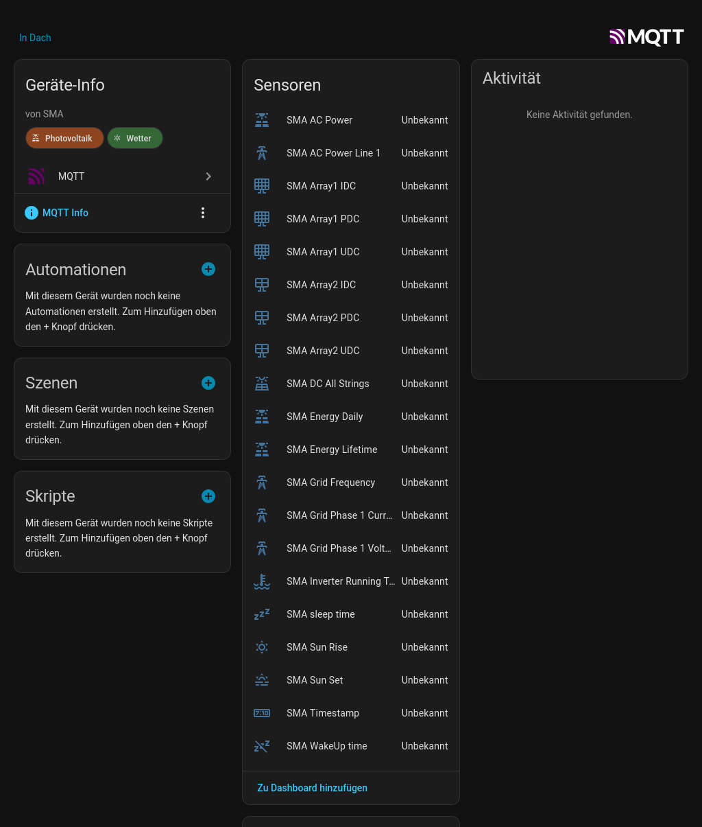

When I go the the devices, I have one Device and the entities are generated, but at all Entities is the Status"unknown", see german screenshot.
Can anyone explain to me why the data in in the database but can not be shown in Home Assistant?
Have I missed something in the documentation, why the data is not shown in Home Assistant?

Ich habe mittlerweile versucht, etwas tiefer zusehen. Im MQTT EXPLORER ta7cht das Topic kurz auf, verschwindet dann aber wieder.
Wenn es da ist, dann kann man die Auflistung mit den Werten sehen, aber dann verschwindet es wieder.
Sehr seltsam…
Grüße
Robert
Warum kann ich nicht sagen.
I have now tried to look a little deeper. The topic appears briefly in MQTT EXPLORER, but then disappears again.
When it is there, you can see the list with the values, but then it disappears again.
I can’t say why.
Very strange…
Best regards,
Robert
I have found a solution.
First, I uninstalled the add-on and deleted all sensors, etc.
Then I reinstalled it but did not start it yet. Next, I re-entered all the information, making sure that everything was correct.
Now I saved everything. Only then did I change the option for creating sensors from ‘No’ to ‘CREATE’.
Only then did I start the add-on, and now the data was there and stayed there.
It was a difficult bith.
