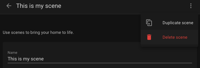

In case you search and come to here. Click on one scene → right-top “…” is the place to delete it.
So simple, yet I missed it. Thanks for this follow up. Yes I did search and come here, and your response made this simple problem, and go away. New to HA, so these sorts of comments are gold!
Thanks. I’m surprised they didn’t position that DELETE button by the side of the SAVE button down the bottom right hand side of the scene page.

Hi! Where I can find it? My Scenes differs from this screen.
