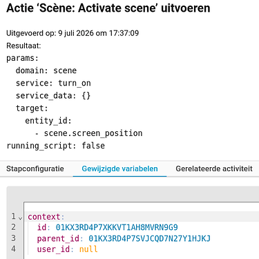

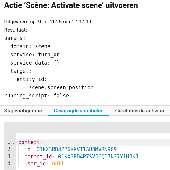

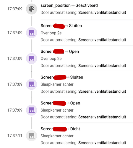

The HA core logs don’t show anything, the automation trace shows this:
Related activity:

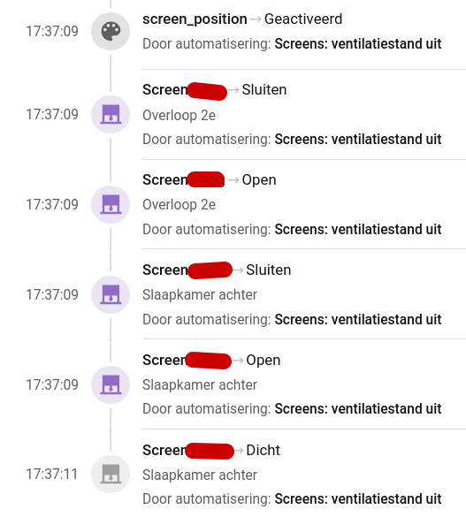

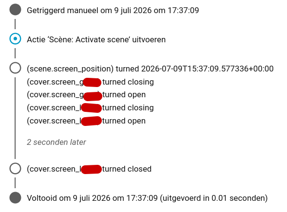

That is a very quick succession of opens and closes. Are those the same covers being opened and closed in the same second?
Those are two screens total, yes (the ones listed in the snapshot_entities in the automation). The screen that restores its previous position has smooth movement, I only see a single movement there. One click from the motor as well. So the subsequent open/close in the log does not seem to translate to screen movement.
I’m not sure why HA thinks the screens should open, as the screens’ positions should be restored. In this case, they were fully closed before they were moved to venting position. So they should only be closing, not opening.
The second screen clicks and stalls immediately. A bit less anonimised, where you can see it’s two screens, and only one actually gets closed:

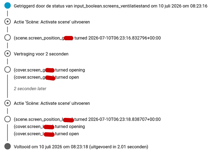

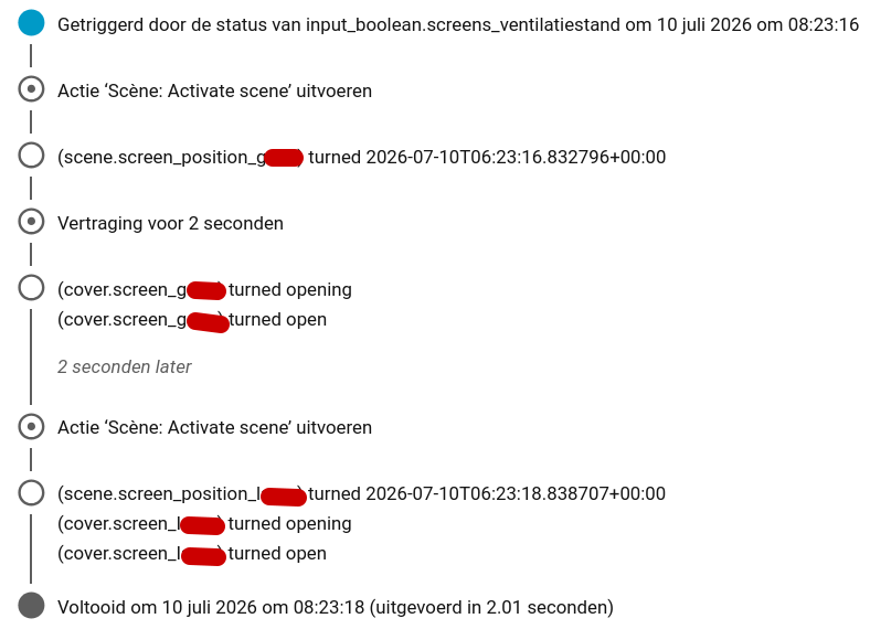

Thanks. I already split it into two separate scenes, without the delay though. Both screens just stay stuck at 10% then. The delay does not seem to make a difference.
(I’ve switched to a boolean so I can use a button switch in the UI, but that shouldn’t make any difference for what’s happening here.)
alias: 'Screens: venting'
triggers:
  - trigger: state
    entity_id: input_boolean.screens_ventilatiestand
    from: 'on'
    to: 'off'
conditions: []
actions:
  - action: scene.turn_on
      entity_id: scene.screen_position_1
  - delay:
      seconds: 2
      entity_id: scene.screen_position_2
