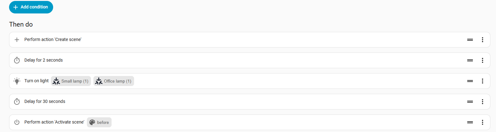

So im using the following
Create scene and then activate scene to change the colour of the light back to the last used colour and state.
It works unless the lamp is off and in which case it doesnt reset the colour back to the original colour. It switches it back off (i.e the light was off in the first place) but keeps the light red.
Any ideas how i can resolve this?

That’s brilliant. Thank you so much. I’m off to try now :smiley:
Drat i still cant get it to work.
It seems to not set one of the lights colour back every time.
Ok so if the bulb is on it works fine. It captures the state and reinstates it.
If the bulb is off then the buld will return to its power state but it wont reinstate the colour.
Ive tried seperating these out into distinct items and scenes and it doesnt seem to make any difference.
It would be good to report the power and colour options separately so i can trouble shoot?
