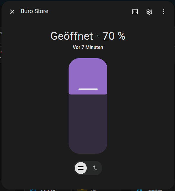

No matter where the cover is positioned when I apply the scene the cover does not move. But I hear a “cllick” from the engine, that tells me some command reached the cover through KNX, and the visualization of the entity moves to position 70%, but not the actual cover:
If I drag the slider from above image, the cover moves to the desired percentage position. I also tried an automation that I manually triggered to see if the cover works this way as well. This works also if manually triggered:
