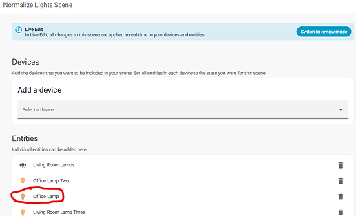

I have several automations that change various lights colors. E.g, red for severe weather, blue for detected water leak, and purple for the Catlink C1. I'm trying to create a scene that reverts the lights back to their original non-color settings named "Normalize Lights Scene" So just using the office lamp as an example, it was turned blue by an automation. So in "Live Edit" I changed the light back to it's normal color (3000k), and save the scene. But when I "Switch to review mode", the light changes back to blue.
What do I have to do to keep the light at the 3000k setting?

Once you have switched out of Live Edit, click "Apply" in the 3-dot menu to set all lights to the Scene-defined values.

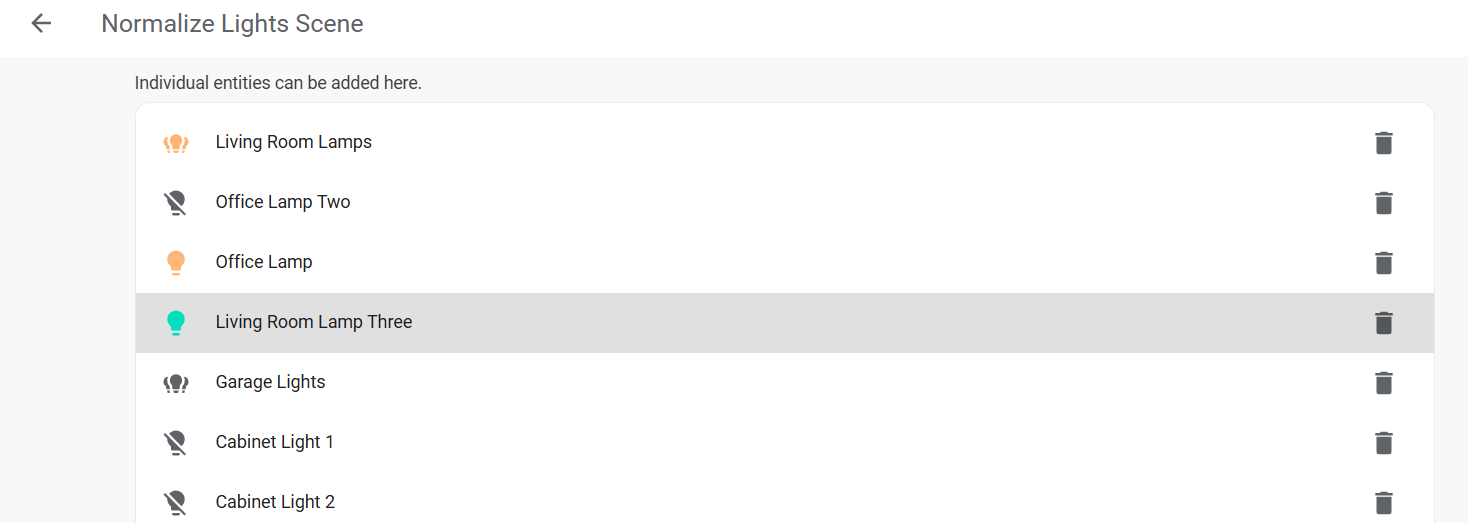

Okay, it's still driving me nuts. I set all of my lights to a "normal" state in my "Normalize Lights Scene". Then saving and pressing "Apply" as you suggested. Then I change Living Room Lamp Three to a teal color. Then I access the Normalize Lights Scene and click Apply, and the light remains teal. It doesn't seem to remember the states that I set the lights to.

I actually have another scene named "Teal Dream" (My wife's favorite color) that changes all the lamps to teal. Then I thought I would run the Normalize Lights Scene to put the lights back to their original state.
