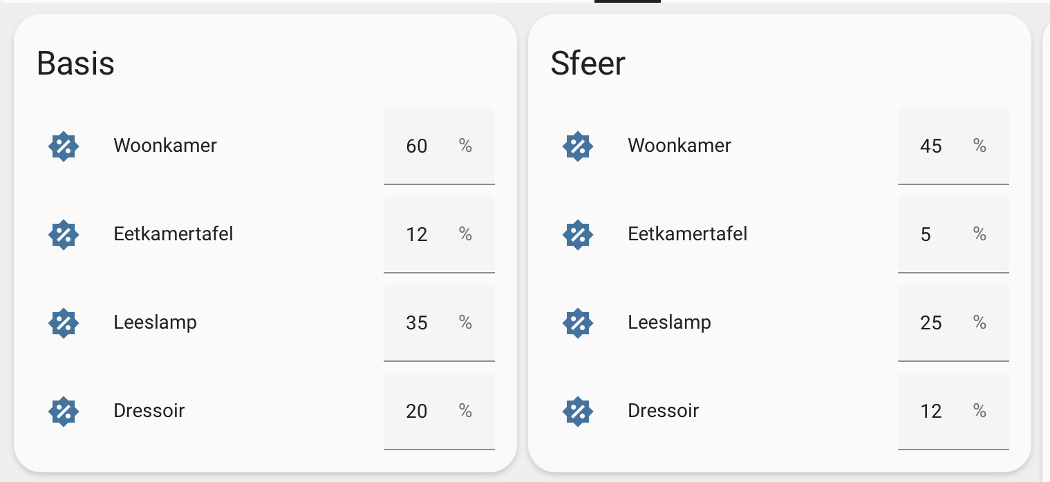

The captured scene data is not usable one on one, but you can use it to see the current values for the thing you are interested in. I use developer tools instead to see what things are relevant and what their current value is. Then I use the script editor to write the actions, such as light.turn_on to set brightness and color or pick a preset. I might use conditionals to alter some things or use an input_number to configure some things of the scene in a dashboard:
Or, when you want to turn a lot of things off when you go to sleep, you can set a sleep label on all the entities, and call homeassistant.turn_off on the sleep label. Scenes can’t compete with that. I dare you to edit a real sleep scene in the evening :slight_smile: . It was one of the first things I did when discovering and editing scenes. And it was the last time I edited a scene using the scene editor.
