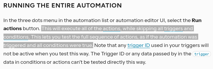

All your actions are set to skip the conditions in the automations they are triggering, like the “Night Temperature” automation. So, based on the provided examples, everything is working as it has been configured to work.
If you want…
conditions:
  - condition: state
    entity_id: schedule.night_schedule
    state: "on"
… to be respected when called by the “Away Temperature” automation, then you need to set all the skip_condition option to false.
FWIW, none of the And conditions in the “Away Temperature” automation are doing anything except making it harder to read. The only time when an And condition is needed is inside an Or or Not condition.
could you show me an example for Night Temperature so I can fully understand what you mean.
I wouldn’t say the issue is with “Night Temperature”, it’s with “Away Temperature”…

But I guess you could also avoid this problem by changing “Night Temperature” as follows:
alias: Night Temperature
description: ""
mode: single
triggers:
  - trigger: state
    entity_id:
      - schedule.night_schedule
conditions: []
actions:
  - condition: state
    state: "on"
  - action: climate.set_temperature
    metadata: {}
      temperature: 16
      entity_id:
        - climate.master_bedroom_radiator
        - climate.office_radiator
        - climate.living_room_radiator
        - climate.kitchen_radiator
        - climate.dining_room_radiator
    metadata: {}
      temperature: 26
      entity_id:
        - climate.bathroom_radiator
        - climate.hallway_radiator
By moving the condition from the Conditions block to the Actions block, it is no longer affected by the skip_condition option in the calling action automation.trigger.
Thank you for showing me the simple, yet annoying mistake made by me .
