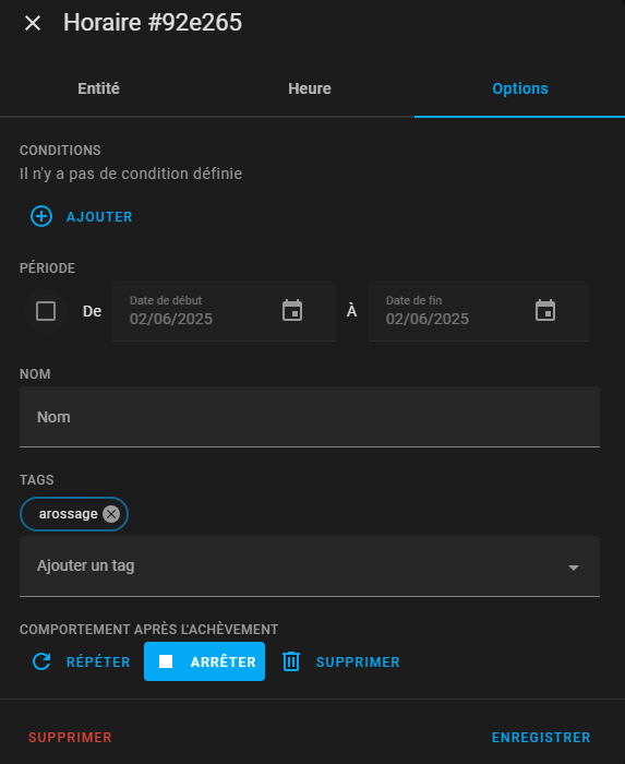

Hello everyone,
Thanks to the creator.
I have a quick question. When I create a schedule, this appears every time. Is there a way to remove it?
Thanks.
Remg,
If you click on the “+2 entrees exclues”, those schedules excluded (from displaying) should appear.
It has to do with the tags you assign to a schedule, and the tag filter(s) in the current Scheduler Card (the Options page of a Scheduler shedule).
Hello, thank you for your reply. Unfortunately, I can’t find anything in the options section. Sorry, I’m not an advanced HA user yet.
Thank you.
See in your image, the TAGs area at the bottom.
This Scheduler window will only show your schedules that are tagged “arossage”. You likely have two other schedules that weren’t assigned the tag “arossage”

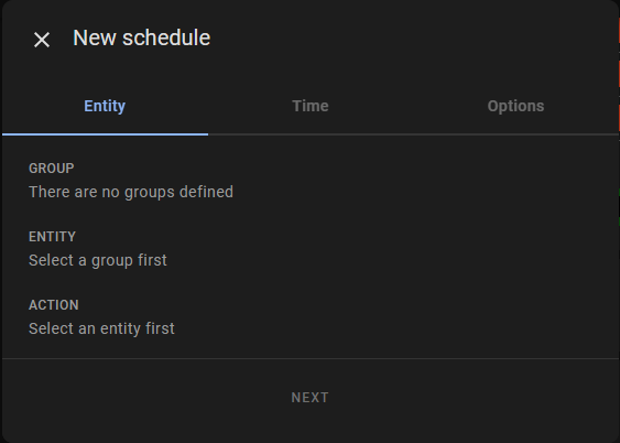

This used to work, but now there is nothing showing up and I cannot select anything.
[SOLVED] Had to delete all of the yaml code and use a similar setup from this thread to get it to work.
